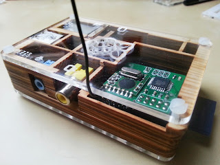

After several Raspberry Pi emonBase SD card failures between myself and Glyn in the last two weeks and the general experience of short SD card lifespan on the forums (SD cards have a limited number of writes), we thought we'd make a concerted effort this week to move the openenergymonitor Raspberry Pi documentation, pi images and pre-installed SD cards over to the more stable solutions:
Raspberry Pi emonBase with RFM12Pi in Pibow Timber Case

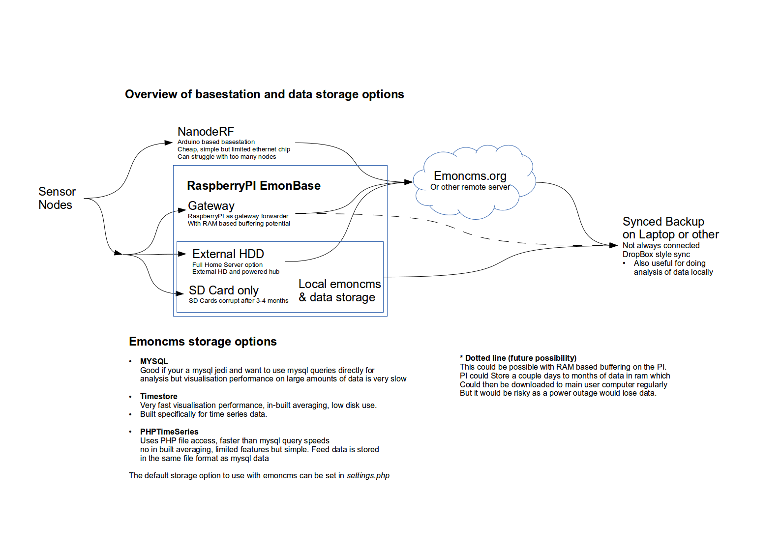

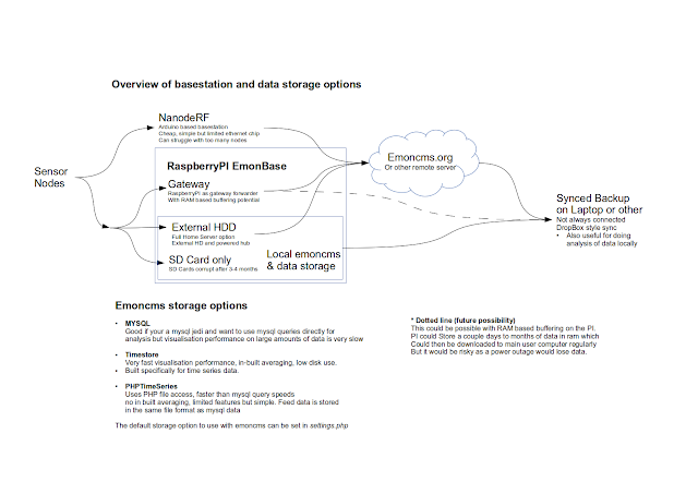

Here's a diagram that illustrates these different options, including the NanodeRF, local and remote storage, backup options and emoncms data storage options (mysql, timestore etc):
If your not sure which way to go, its probably easiest to start with the Raspberry Pi oem_gateway forwarder to emoncms.org, you can re-configure it for local storage and backup via an external harddrive if you want later. If your more comfortable with Arduino code than the Raspberry Pi and linux then the NanodeRF (pre-assembled SMT) may be best for you.
To summarise the above with pros and cons, here are the two main emonBase Raspberry Pi options:
1. Run a read only filesystem on the Pi and forward data straight to a remote emoncms server.
Developed by Jerome Lafréchoux and Martin Harizanov's
http://harizanov.com/2013/08/rock-solid-rfm2pi-gateway-solution/
  • + More robust and easier to setup
  • + Cheaper and lower power than using an external HDD
  • - Does not utilise the full potential of the Pi
  • Run IPE – Industrial Perennial Environment a special blackout-proof flavour of Raspbian which can be locked down after setup to work in read only mode
  • The Oem Gateway Python script by Jérôme Lafréchoux to forward the data received by the RFM12Pi straight to emoncms.org
2. Move the Pi's file system to an external HDD using the SD card only to boot
This option requires an external hard drive connected to the Pi through a powered USB hub. This does require extra expense and an increase in power consumption, the hard drive we tested here a 1TB USB hard drive adds 1.8W to the power consumption of the Pi (3.9W). However this option does have several advantages:
  • + Ability to run emoncms on the Pi to log data locally and have full control over your setup as well as forwarding data to a remote emoncms server.
  • + You now have the potential to have 24/7 file server running in your house for music streaming document backup etc.
  • - More complicated to setup
  • - Higher cost and power consumption

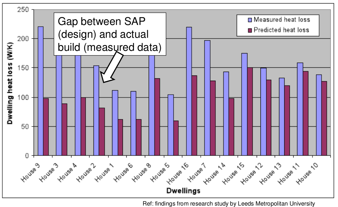

Measuring building thermal performance - coheating tests
Improving the thermal performance of buildings is an area where some of the largest energy and carbon savings can be made. Building energy use and carbon emissions can be reduced by as much as 60-80% through better insulation, draught proofing (improved thermal performance) and heating efficiency and controls. But how do you go about working out the performance of your house and what measures are best to undertake to reach this level of performance improvement? Improving building fabric is expensive, how do you work out which measures will be most cost-effective? and how do you make sure that your house actually achieves the target performance? how do you measure and check it?
These are the questions I’m currently grappling with for my own house and the openenergymonitor lab, these are also the questions we’re trying to develop improved processes for answering with our work with Carbon Coop.
Here’s a graphic from the Centre for Alternative Technology’s Zero Carbon Report illustrating the kind of performance improvements that are possible:
The most common way to investigate domestic building performance is by using simple building energy models such as SAP:
http://openenergymonitor.blogspot.co.uk/2013/06/building-energy-modelling-carbon-coop.html
The accuracy of a model is always dependent on its input data and assumptions, work that has been done on comparing modelled energy consumption as calculated by SAP vs actual energy consumption show that there is often a discrepancy and in some cases the discrepancy is so large (even a 100% or more) as to undermine decisions made based on model outputs.
https://www.bsria.co.uk/download/asset/agm-2011-co-heating-tests-sarah-birchall.pdf
To rely therefore on modelled performance only can be misleading.
