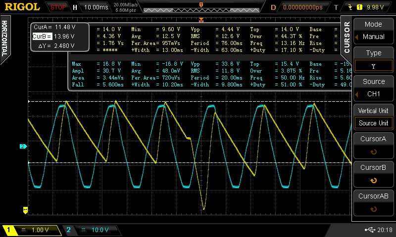

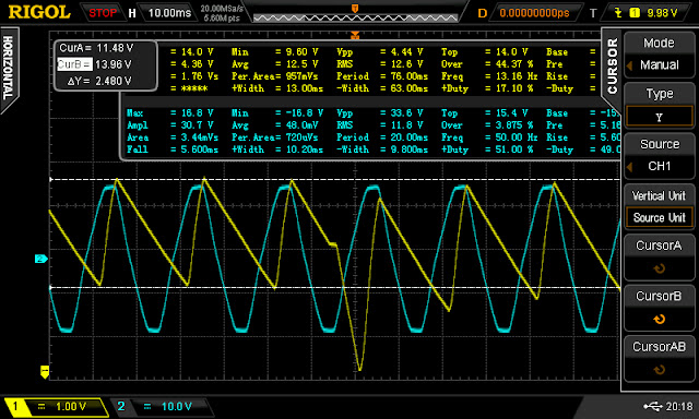

The AC-DC circuit that was initially designed with the aid of simulation then bench tested is performing as expected.
Blue = output from 9V AC adapter Yellow = input to voltage regulator when unit is drawing 7.7mA  @ 3.3V, sudden dip is caused by RFM12B firing up to transmit four integer data packets (approx 24mA for 2.7ms)
