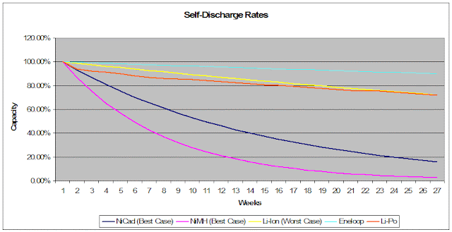

If rechargeable batteries are used (which they should be) the self-discharge rate can be significant. The self-discharge rate of NiMH batteries is high: around 30% per month at room temperature. This problem can be almost eliminated by using low-self discharge NiMH cells such as Eneloop, they have a discharge rate of about 5% per year. If non-rechargeable alkaline batteries are used they have a self-discharge rate of less than 2% per year.
Rechargable batteries self-discharge graph from batterydata.com
