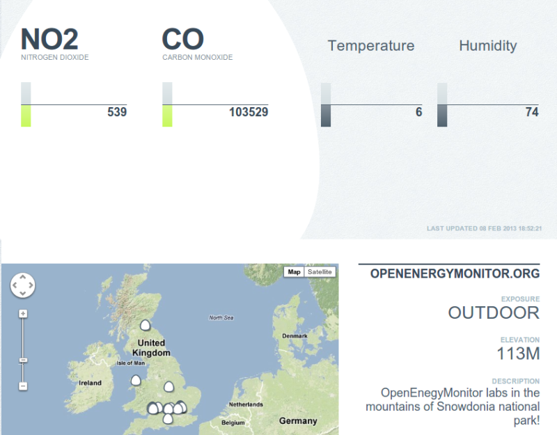

IoT Cloud - Cosm is used as the data store for the AQE. A neat open-source Ruby web-application has been written to display a crowd sourced web-dashboard with a nice Google map showing egg monitoring locations.
| http://airqualityegg.com/ - let's get some more European eggs activated! |
| Example Air Quality Egg Readings from the OpenEnergyMonitor labs, readings may be in-correct. Sensors take a few days to 'burn-in'. See here for the live version: http://airqualityegg.com/egg/103153 |

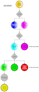

In summary setup is as simple as:
- Head to http://airqualityegg.com/ and enter the serial number on the AQE box
- Plug in the base station - watch for LED illumination sequence (green LED) to confirm successfully connection (or connect FTDI on baud 115200 for more verbose confirmation)
- Pair sensor egg to base station by un-plugging the base station, then plugging it back-in then connecting the sensor egg when the base station glows yellow. Base egg will cycle through a number of colours to confirm pairing.
- Deploy sensor egg somewhere in the open air (but undercover) within 100ft of the base
| Base-egg LED colour status debugging from Wicked Device Blog |
