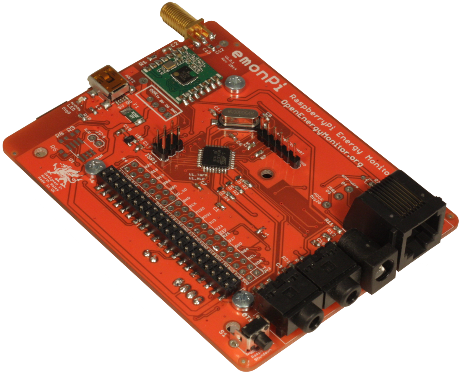

Introducing emonPi: Raspberry Pi based energy monitor
emonPi Raspberry Pi based energy monitor Kickstarter
It's an exciting time for us; this week (on the 1st April, unfortunate timing!) we launched a Kickstarter crowd funding campaign for our emonPi Raspberry Pi based energy monitoring unit.
The emonPi has been in development for the past 12 months or so, if you have been lurking on the forums you have probably seen activity on the emonPi's open development forum thread. Thank you everyone who contributed.
The emonPi has been developed with input from the community, merging the monitoring unit and web-connected base station into a single easy to install and setup energy monitoring solution.
The emonPi is fully open source hardware and software. It's been designed for maximum hackability and customisation being built on a fusion of two popular open source hardware platforms Arduino and Raspberry Pi.
emonPi Technical Features
  • Two channel CT monitoring with AC sample input
  • Compatible with Raspberry Pi model A, model B, model B+ and Pi 2
  • Arduino compatible ATmega328 with ability to remotely upload sketches vis Raspberry Pi Serial
  • RJ45 DS18B20 on-wire temperature bus to allow many temperature sensors to easily be added using a RJ45 breakout board for heat pump monitoring applications
  • PWM and IRQ I/O's on RJ45
  • Status LCD with function push button
  • Raspberry Pi shutdown button
  • RFM12B / RFM69CW with SMA antenna to receive or transmit data from other sensor nodes
  • Option to add OOK (on-off keying) transmitter footprint for controlling remote plugs etc.
  • Option to add EEPROM to enable Raspberry Pi HAT compatibility (please get in contact if you have experience setting up Linux device tree).
  • Open-source hardware, firmware and software
  • High quality custom made, wall mountable enclosure
See the emonPi wiki for more technical info (currently under development).

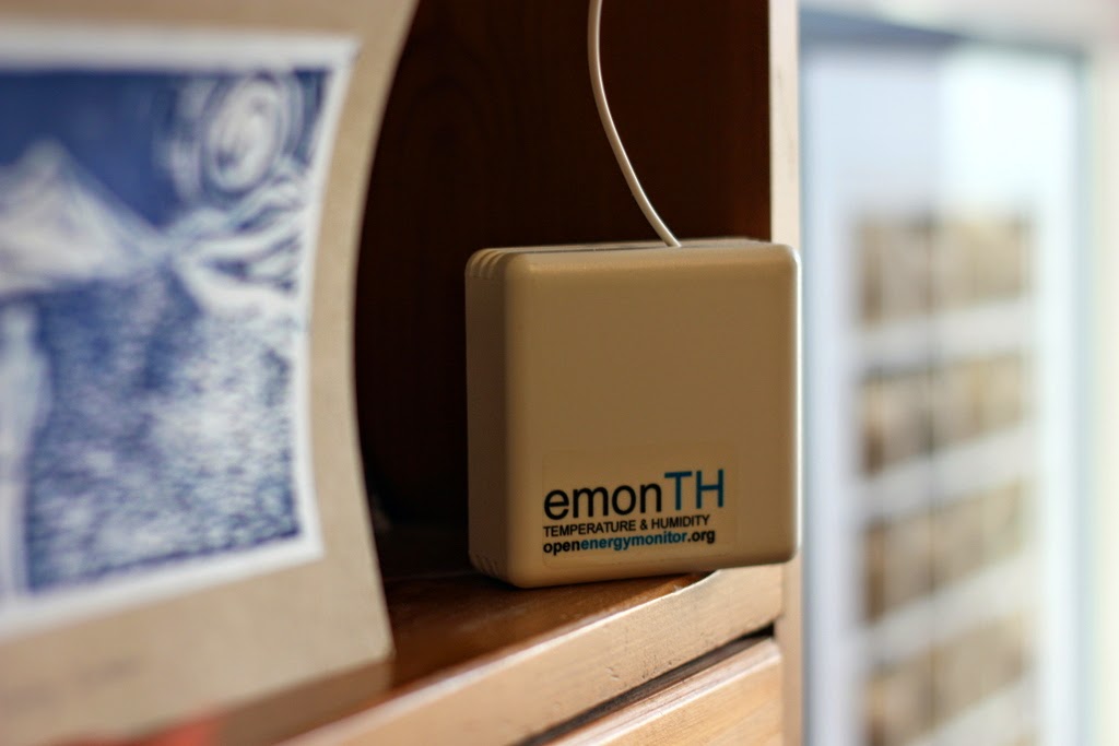

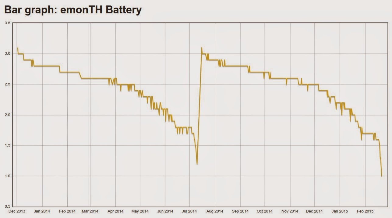

Real World emonTH Battery Life
The battery on my home emonTH Temperature & Humidity Node has just died for the second time in 14 months. Each set of batteries lasted exactly 221 days (7 months and 9 days)! The 2 x AA alkaline battery voltage started at 3.1V and the emonTH stopped working just after the voltage dropped below 1.2V (final dying breath was at a battery voltage of 0.8V!).  The two AA batteries installed were low cost alkaline batteries unbranded from e-spares. Battery life would not doubt be longer from some quality cells.
I recommend using rechargeable alkaline batteries if possible in the emonTH, for least environmental impact. See my previous posts on emonTH battery selection and power consumption optimisation.
My emonTH had a DHT22 temperature and humidity sensor connected and was set to the default post rate of one minute in-between samples. The unit was running V1.0 firmware (the firmware is now at V1.2, there have been a couple of minor battery life improvements).
It's very impressive how the DC-DC boost converter onboard the emonTH continues to boost the depleting battery voltage to 3.3V, using this method allows the battery to be drained much further than powering the unit directly.

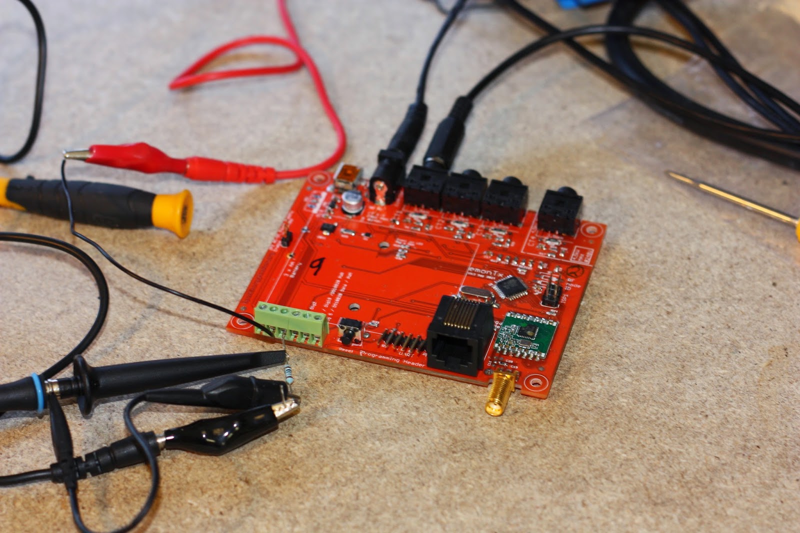

Following on from my post on RFM12B power consumption here's the same measurements for the RFM69CW (see RFM69CW intro blog post).

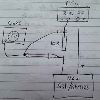

Current consumption was measured in the same way as explained in the RFM12B post back in July 2013. Voltage drop was measured across 10R current shunt resistor.
A fully populated emonTx V3.4 with a 433Mhz RFM69CW running discrete sampling code with a single CT connected was used in the test. The V3.4 was powered directly with 3.3V DC from bench PSU.
emonTx V3.4 with RFM69CW Test Setup
Test setup illustration
Test Bench

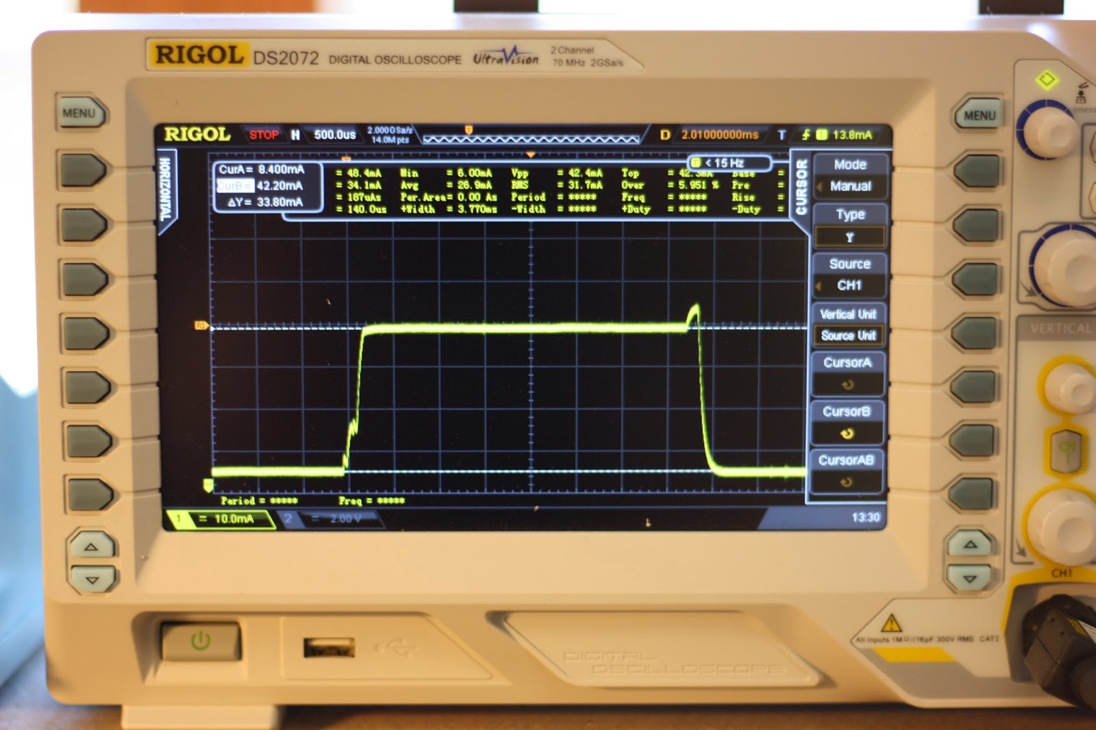

Please excuse my photos of the scope traces rather than screen captures, for some reason the USB socket on the scope did not seem to be working today :-(
Full sample and RFM69CW transmit trace capture
When an AC-AC adapter is not connected the emonTx goes to sleep in between readings. The above current trace shows the ATmega328 waking up for 295ms to sample from one CT channel the spike at the end is the RFM69CW transmitting. The trace below is a zoomed in capture of the RFM69CW transmission and LED.
RFM69CW transmission current consumption
The current trace above shows the RFM69CW transmission: 33mA @ 3.3V (109mW) for 4ms. The current spike at the end (up to 39mA) is the emonTx LED. In this test the emonTx was running the standard discrete sampling firmware transmitting a JeeLib packet structure with six integers. Since we were only sampling from one CT four out of the five integers will be zero.
This equates to a 15 bytes payload plus 9 byte overhead @ 48kb/s. See JeeLib packet structure.
In comparison I measured the RFM12B to consume 25.5mA @ 3.3V (84.2mW) for 3ms.
My measurements pretty much agree with the datasheets, here's a comparison table compiled by Low Power Labs:
Even though the RFM69CW does consume more power while it's transmitting it does have a lower sleep consumption than the RFM12B. This increased transmission power should result in an increased transmission range.

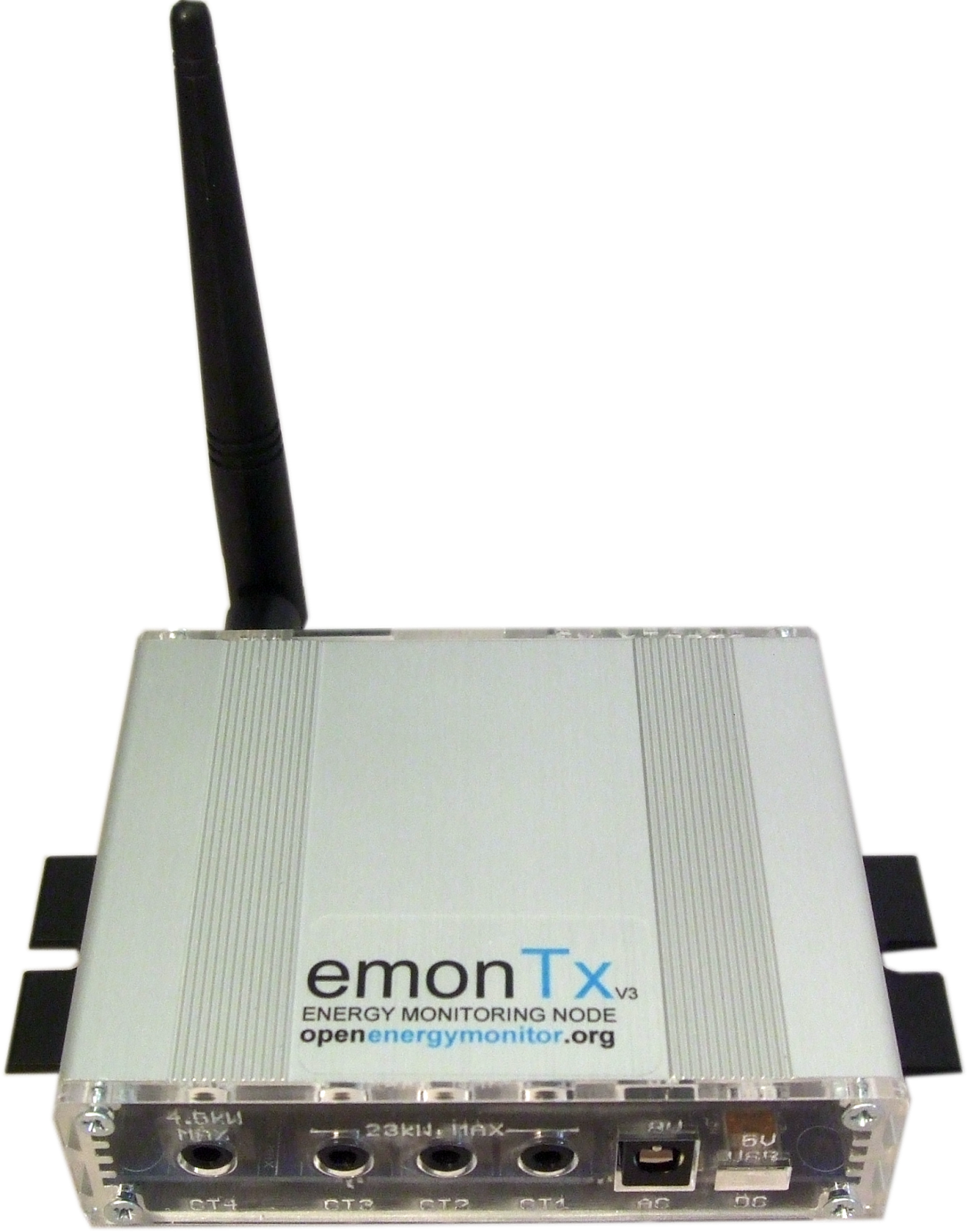

Introducing emonTx V3.4
Now shipping later this week in the shop is an updated version to the emonTx V3. This is a relatively minor update feature and form factor wise, most users probably won't notice the difference. However when hardware is involved, no update is a minor update!
emonTx V3.4 is now available from the OpenEnergyMonitor Shop
The main changes  are under the hood; the ATmega328 Arduino compatible microprocessor is now is now laid down directly on the PCB. This will help with manufacture and give us a few extra I/O to pay with that were inaccessible on RFu328 module that we used on the original emonTx V3.2. The changes also bring us back in line with JeenNode hardware (IRQ and INT connections) which allow us to use the latest RF12 JeeLib library to support the RFM69CW (see separate post).
emonTx V3.4 Installed
emonTx V3.4 - production units will have battery holder fitted - omitted for photo to show components

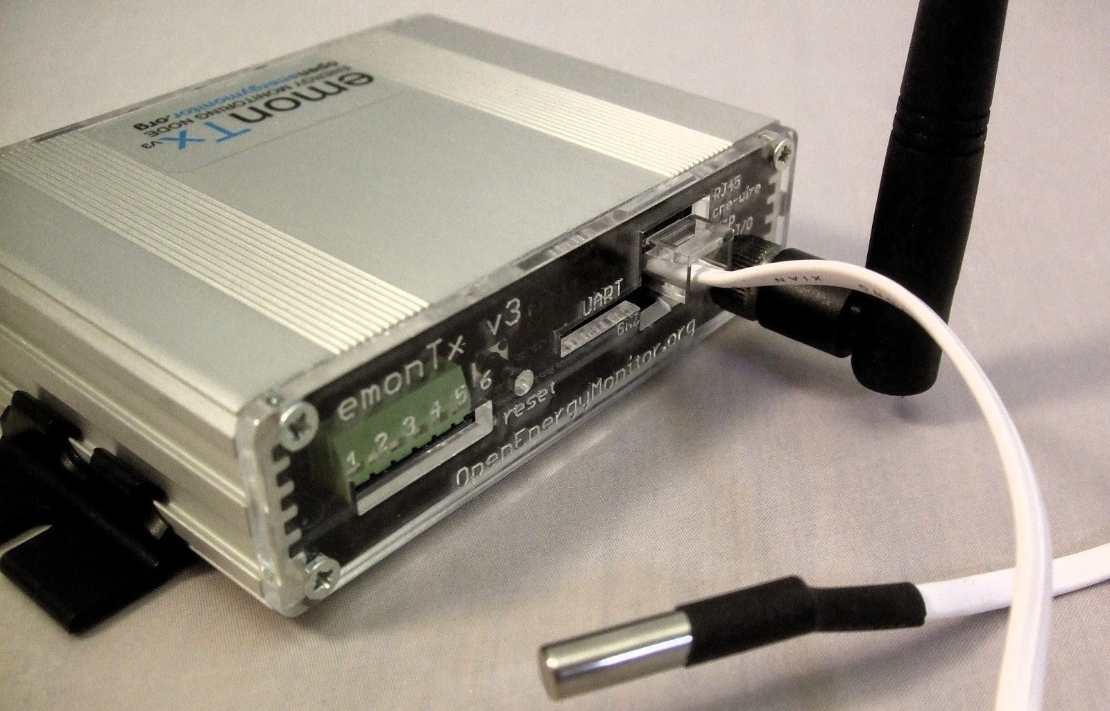

The emonTx V3.4 has the addition of an RJ45 socket to allow ease of connecting multiple DS18B20 temperature sensors. Screened RJ45 cabling (Ethernet) is commonly available as well as RJ45 splitters and extenders. This makes a quick and easy way to wire up a house / heat-pump etc for temperature monitoring. Power, GND, IRQ, ADC and PWM I/O's are also available through the RJ45 connector, see wiki for pinout and technical details.
Note: the RJ45 connection is not Ethernet, TCP network switches and routers should not be used
RJ45 connector used with RJ45 terminal breakout for connection of multiple encapsulated DS18B20 temperature sensors, DS18B20 temperature sensors are also available wired directly on RJ45 connector
DS18B20 Temperature Sensor on RJ45

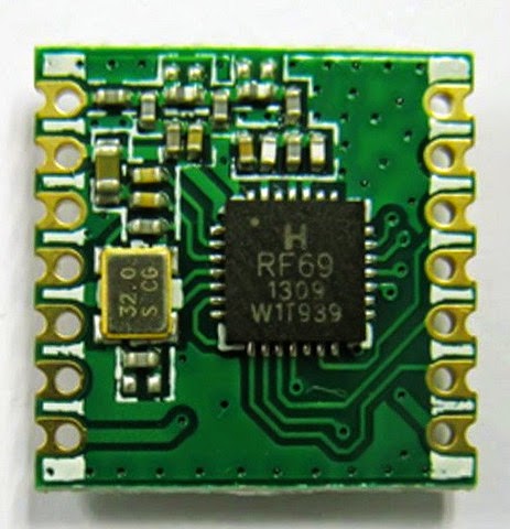

Introducing RFM69CW
For sometime now the Hope RF RFM12B module has been our RF module of choice. This module was chosen for it's low cost, decent performance and importantly for us, an active development community. On the software side we use the excellent JeeLabs JeeLib RF12 Arduino library.
About a year ago Hope RF announced the RFM12B to be 'EOL' (End-of-Life), there has been a degree of confusion as to what exactly this means; currently manufacture of the module is still taking place and supply is still easily available. However, we acknowledged that the time had arrived to look for alternatives since Hope RF no longer offers support or recommends the RFM12B for new products.
An obvious alternative that was explored by JeeLabs  is the Hope RF RFM69CW module, it uses SEMTEC designed silicon (as opposed to Silicon Labs in the RFM12B). It's pin-compatible with the RFM12B. Using the updated JeeLib driver the RFM69CW is be backwards compatible with RFM12B helping users of RFM12B to make a smooth transition. Thanks to JCW from JeeLabs and LowPower Labs for the work on developing the RFM69CW Arduino library. We have been working with JeeLabs to source modules and test the driver software.
Hope RF RFM69CW
I will let JeeLabs/DigitalSmarties introduce the module
"The recently announced RFM69CW radio module by HopeRF is a compact, powerful radio transceiver module for swapping data packets in the 868 MHz ISM band, using standard and enhanced FSK modulation. Great for sub-compact designs; just 4mm of mounted height from using an SMD precision crystal.
Though consuming a similar level of power, the RFM69CW receiver section can decode fainter signals than the classic RFM12B. The transmitter section *maximum* output power is +13dBm, considerably higher than the +5dBm of the RFM12B. The current drain at these (adjustable) higher power settings is correspondingly higher. With the better receiver sensitivity, many applications will not need to use the higher transmit power settings, potentially saving on battery life.
Comparing like-with-like, pairs of modules will generally have greater range and/or better penetration of walls/ceiling than when using pairs of the classic RFM12B.
The physical module is compatible with the PCB footprint on all current JeeNodes and JeeLinks. For details of the fast-evolving level of software support, see this Forum topic.
Control is via a fast SPI bus with reduced MPU loading. The recommended power supply range of 1.8 < Vdd < 3.6 V can squeeze almost the last energy out of depleting batteries without needing a boost converter."

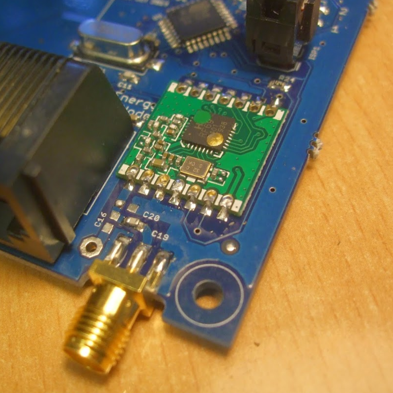

Early next year we will start transitioning to the RFM69CW, end-users should not notice a difference apart from a new input on the emoncms Inputs page 'RSSI' (Received Signal Strength Indicator), see below.
To simplify manufacture and module sourcing we will be standardising on 433Mhz, we will make available no-RF versions of units for users who wish to solder on their own 868Mhz modules. See forum thread
RFM69CW on the emonTx V3.4
For early adopters we have limited numbers of RFM12Pi Raspberry Pi Expansion with RFM69CW module in the shop. Using the latest emonHub software (currently in 'Testing' branch) using the RFM12Pi with RFM69CW on a Raspberry Pi should be seamless, emonHub automatically detects the higher baud rate requirement of the RFM12Pi with RFM69CW (56700 as opposed to 9600 with RFM12B RFM12Pi) sets baud accordingly and starts posting RSSI (received signal strength indication) to emoncms.
