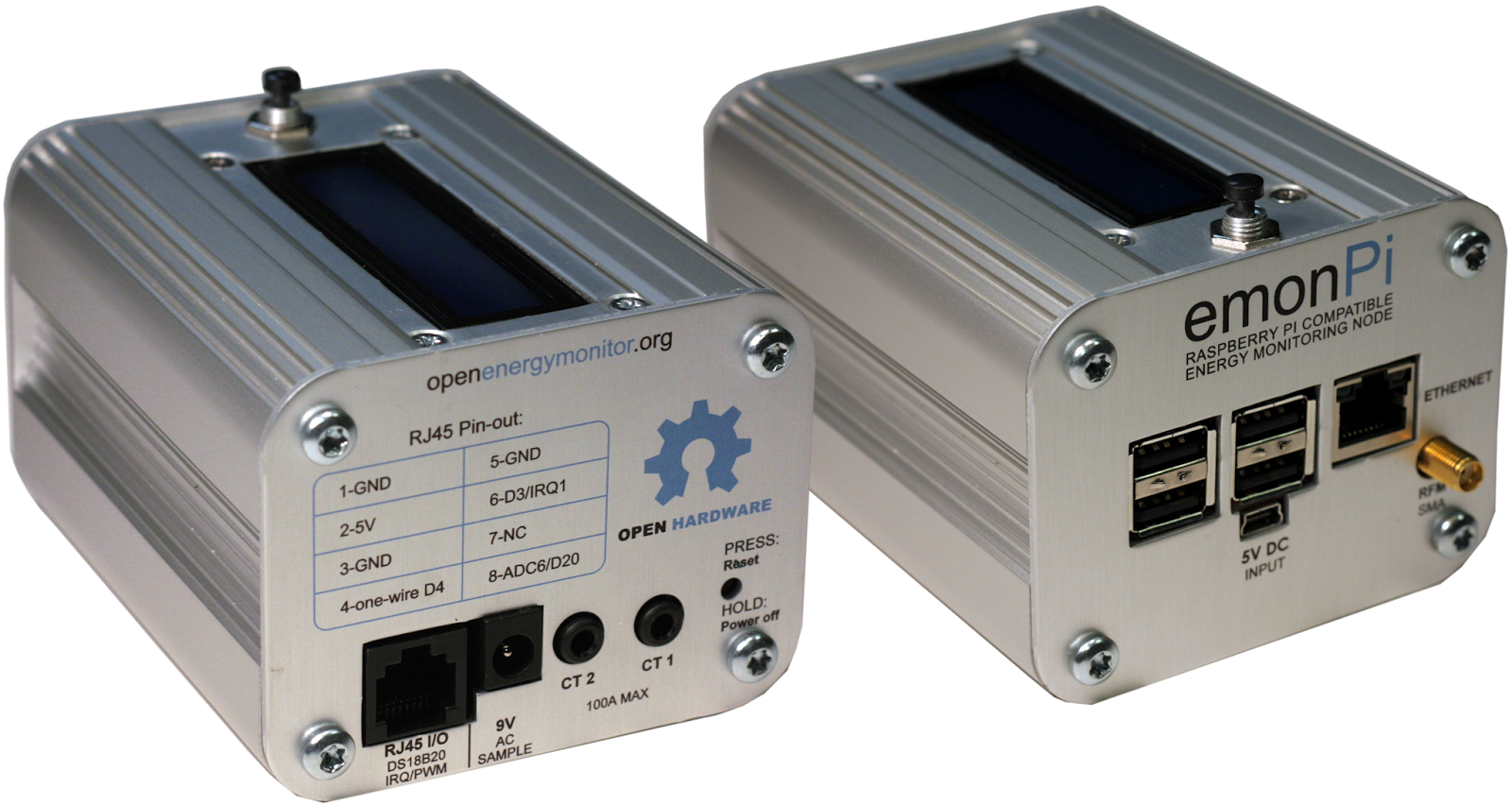

The emonPi has been developed with input from the community, merging the monitoring unit and web-connected base station into a single easy to install and setup energy monitoring solution.
The emonPi is fully open source hardware and software. It's been designed for maximum hackability and customisation being built on a fusion of two popular open source hardware platforms Arduino and Raspberry Pi.
emonPi Technical Features
  • Two channel CT monitoring with AC sample input
  • Compatible with Raspberry Pi model A, model B, model B+ and Pi 2
  • Arduino compatible ATmega328 with ability to remotely upload sketches vis Raspberry Pi Serial
  • RJ45 DS18B20 on-wire temperature bus to allow many temperature sensors to easily be added using a RJ45 breakout board for heat pump monitoring applications
  • PWM and IRQ I/O's on RJ45
  • Status LCD with function push button
  • Raspberry Pi shutdown button
  • RFM12B / RFM69CW with SMA antenna to receive or transmit data from other sensor nodes
  • Option to add OOK (on-off keying) transmitter footprint for controlling remote plugs etc.
  • Option to add EEPROM to enable Raspberry Pi HAT compatibility (please get in contact if you have experience setting up Linux device tree).
  • Open-source hardware, firmware and software
  • High quality custom made, wall mountable enclosure
See the emonPi wiki for more technical info (currently under development).
