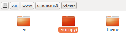

Adding a language
1) Make a copy of the folder Views/en and call it the language your creating a translation for, i.e cy for welsh:
.. or use a language that has already been translated from the emoncms_languages repo, i.e cy...
https://github.com/openenergymonitor/emoncms_languages (feel free to send a pull request with your translations)
2) If your creating a new translation, translate each view script inside your language folder.

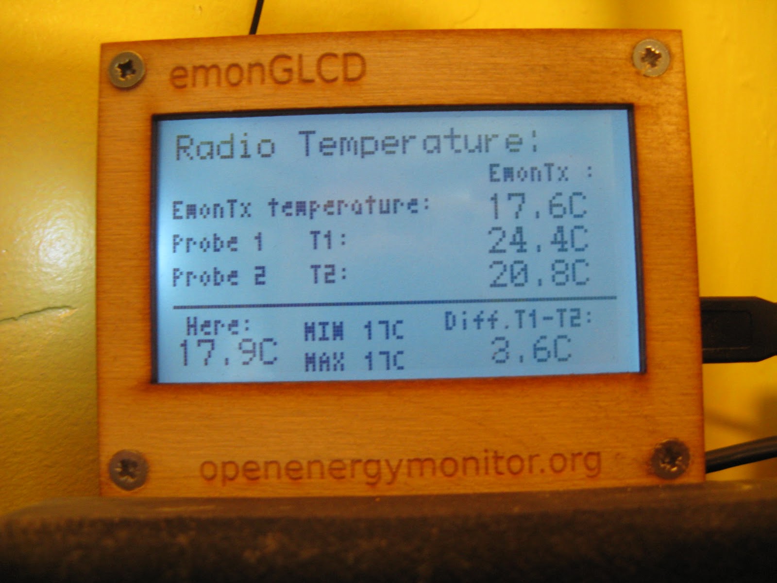

I have just configured an emonGLCD and a battery-powered emonTx unit with 3 temperature sensors. This would make a useful heat-pump engineers tool, and probably has many other uses.
The emonTx has 2 probes (DS18B20's) on 2m cables, and one on-board the PCB. It's battery powered so can be put anywhere in range. The emonGLCD display shows the 3 emonTx temperatures and also a local temperature.  Temperatures are transmitted via wireless from the emonTx to the emonGLCD every 2 seconds.
Typical uses would be for balancing radiators. i.e T1 on the flow, T2 on the return. I have added T1 - T2 (delta T) because that is what you are often looking for.   It could also be used for air-in, air-off off an air source heat pump, or and flow/return situation.   It would make a good tell-tale device. i.e. to alert if any system goes out of its best operating ranges.
I also have the temperatures data going to a Nanode emonBase to be logged to emoncms so that graphs can display temperatures over time. You really need this to balance up central heating radiators. i.e. fix it to a different radiator every day and compare results. The flows can be balanced accordingly.
The DS18B20's are not ideal because they are a bit chunky (as opposed to thermocouples). On the other hand, the accuracy is excellent and it seems that the values can be relied upon. I have chosen to pot-up the probes myself.
They are fragile, and the ready-made sensors from the OpenEnergyMonitor shop are much more rugged and can easily be tie-wrapped to a copper pipe and insulated etc.
Next thing is to battery-power the emonGLCD so it becomes a portable tool.
Another addition would be a LCD pulse input. This would give me a reading of kWh, and would save me using a stop-watch, as I have many over the years.
Adapting these devices could get addictive!!

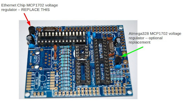

Faulty Batch of MCP1702 Voltage Regulators
We have noticed recently that a number of people have been having problems with the Nanode RF. The problems were brought to our attention through this thread on the forums.
Many people were getting the message "Failed to access Ethernet controller" when running an EtherCard example.
After much testing we have identified the problem. It turns out that the MCP1702 3.3V voltage regulator which supplies 3.3V to the Ethernet Chip (ENC28J60) was not supplying enough current to power the chip. The voltage was dropping down to 2.6V under load.
Swapping the voltage regulator for one from a different batch solved the problem. it looks like we have been sent a faulty batch of voltage regulators, our apologies for not spotting this sooner.
Note: this problem only applies to the MCP1702 voltage regulators in the latest batch of Nanode RF kits. All emonTx and emonGLCD kits are un-effected, they have always used regulators from another source.
If you have this problem we will send out two replacement regulators free of charge, one for the Ethernet chip and the other for powering the Atmega 328, it may be ok to leave the Atmega328 voltage regulator in place as the current requirements are not as high and it seems to work fine here without swapping it out, but we will send two out so that you can swap out as you prefer.
We have created a free voltage regulator entry in the online shop, just quote your previous OpenEnergyMonitor order ID when ordering and we will send them out: http://shop.openenergymonitor.com/nanoderf-mcp1702-voltage-regulator-replacement/.
All the Nanode RF's kits sold through the shop from today onwards will contain the non-faulty voltage regulators.
De-soldering tips
The easiest way to de-solder the regulator is to if possible cut two of the regulator legs, you can then pull out the third by pulling on the regulator body itself while holding the soldering iron tip on the solder surrounding the leg. Then use pliers to pull out the other legs one by one. It is usually easier to pull the legs out if there is actually plenty of (molten) solder around the leg. To clear the holes of solder with a solder sucker again make sure there is plenty of solder in the holes to start with, this usually leaves the cleanest result in our experience. An extra pair of hands can help make the whole job easier.

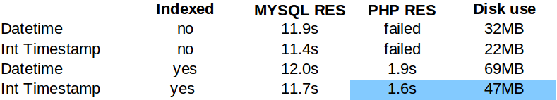

The following table shows the typical times for requesting data from both the indexed and non indexed tables and the different methods. At the same time I also tested whether request times where affected by the data type that time is stored as: mysql datetime or a unix timestamp stored as an unsigned int.
So it looks like the optimum configuration is primarily the addition of an index and use of the php data request method and then to reduce disk space use, switching to unix timestamp. The next step is to create a script to automate table conversion from datetime unindexed to timestamp indexed.
