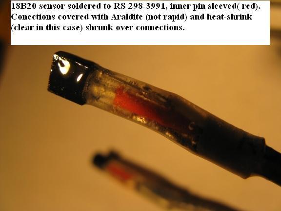

The emonTx has 2 probes (DS18B20's) on 2m cables, and one on-board the PCB. It's battery powered so can be put anywhere in range. The emonGLCD display shows the 3 emonTx temperatures and also a local temperature.  Temperatures are transmitted via wireless from the emonTx to the emonGLCD every 2 seconds.

The DS18B20's are not ideal because they are a bit chunky (as opposed to thermocouples). On the other hand, the accuracy is excellent and it seems that the values can be relied upon. I have chosen to pot-up the probes myself.
They are fragile, and the ready-made sensors from the OpenEnergyMonitor shop are much more rugged and can easily be tie-wrapped to a copper pipe and insulated etc.
