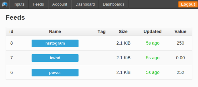

9) Set emoncms database settings.In the folder emoncms3/Includes rename default.settings.php to settings.php. In settings.php enter your mysql username (root) and password, host (localhost) and database name (if as above - emoncms).
10) In an internet browser, load emoncms:http://YOURIP/emoncms3
That's should be it!
