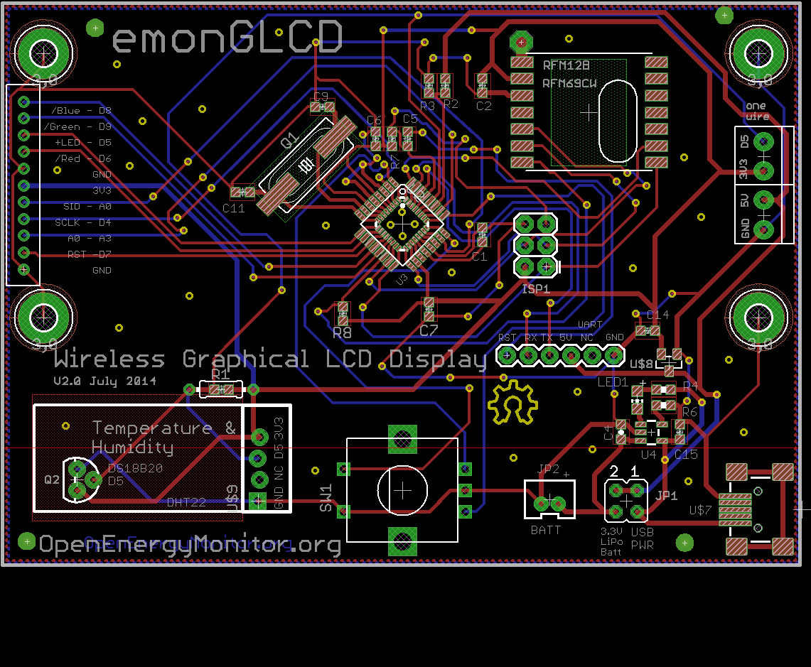

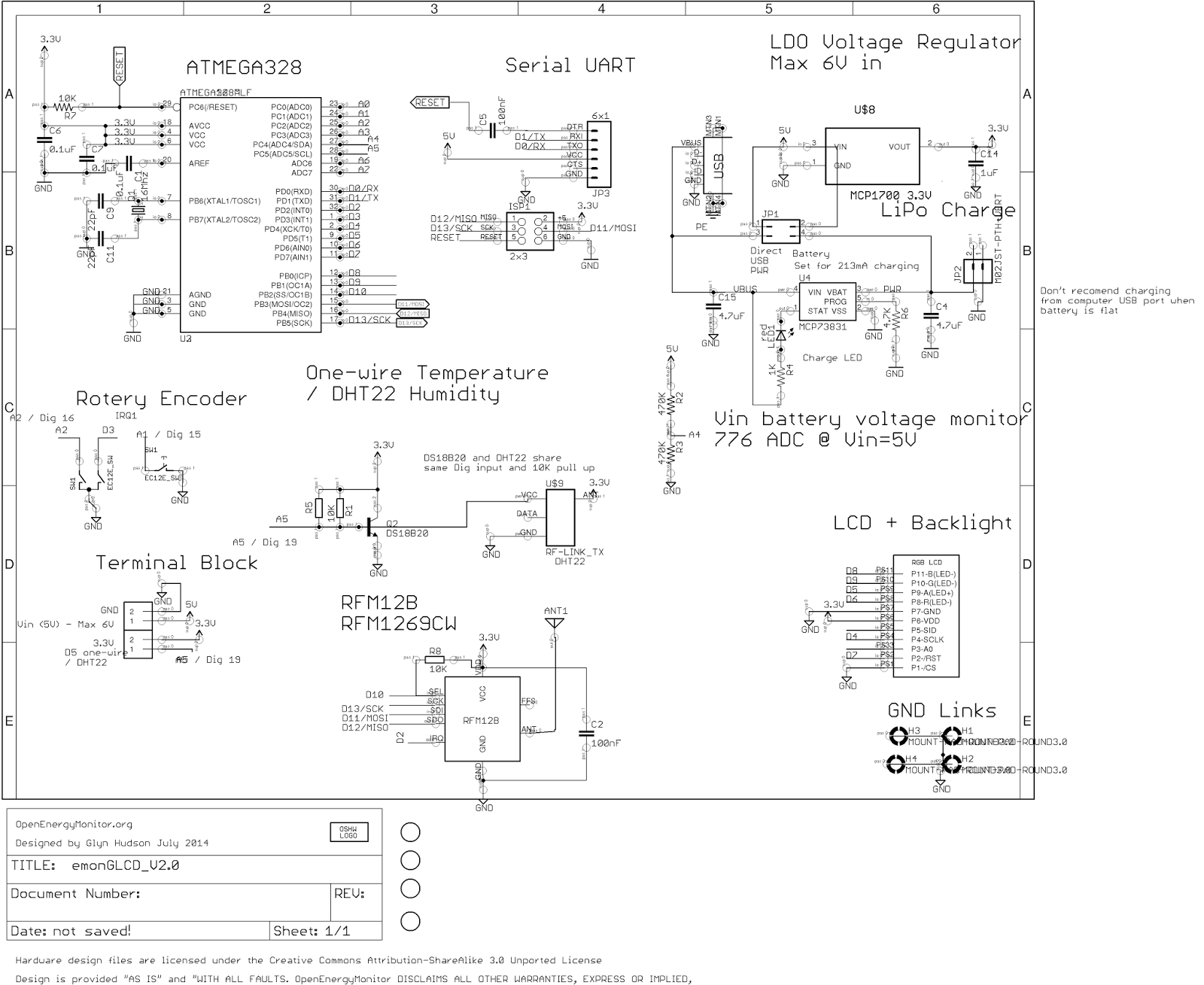

emonGLCD V2 SMT Development
For sometime now the emonGLCD has been lagging behind other OpenEnergyMonitor hardware units in terms of development, we're still selling it only in thru-hole DIY kit form.
We've been thinking about updating it to SMT pre-assembled for some time, however we've been dragged our heels somewhat since there has been thoughts that maybe a smartphone app could fill the same function. However I believe a physical LCD display unit fulfils a slightly different role to a smartphone app. I believe in certain circumstances there is certainly value to having an always-on low power LCD display located in a prominent location displaying current power consumption and or generation.
I have found the emonGLCD with the ambient indication tri-colour LED's to be a really useful easy-to-read indication of solar PV import / export at any given time.
Doing a quick Google search shows that there are lots of emonGLCD being used and customized for all sorts of purposes we could not even have though of! For example: heat pump monitor, temperature measurements, electric car charge rate etc.
With this in mind, we have decided to make an SMT version of the emonGLCD keeping the design largely the same (same LCD panel size and same controller chip ST7565). This will mean the current emonGLCD firmware sketches should run on the new unit with little or no modifications.
I would be interested to heard your thoughts on what you would like in a new version of the emonGLCD?
Over the past few weeks I've made a start to get a prototype, here is the main design criteria and features so far:
  • ST7565 128 x 64 LCD panel with integrated RGB backlight, specifically this Vatronix unit (to replace the LED's on the current version)
  • Single front facing rotary encoder with push-to-select (to replace the three push buttons the the current)
  • Option for lithium battery pack with USB battery charging circuit and battery voltage monitor
  • Arduino compatiable ATmega328 with RFM12B / RFM1269CW
  • Option for on-board DS18B20 and DHT22 temperature and humidity sensors
Using SMT assembly and lower cost LCD unit and enclosure we should be able to reduce the price of the emonGLCD compared to the current version.
Yesterday I sent off for the first prototype PCB revision:

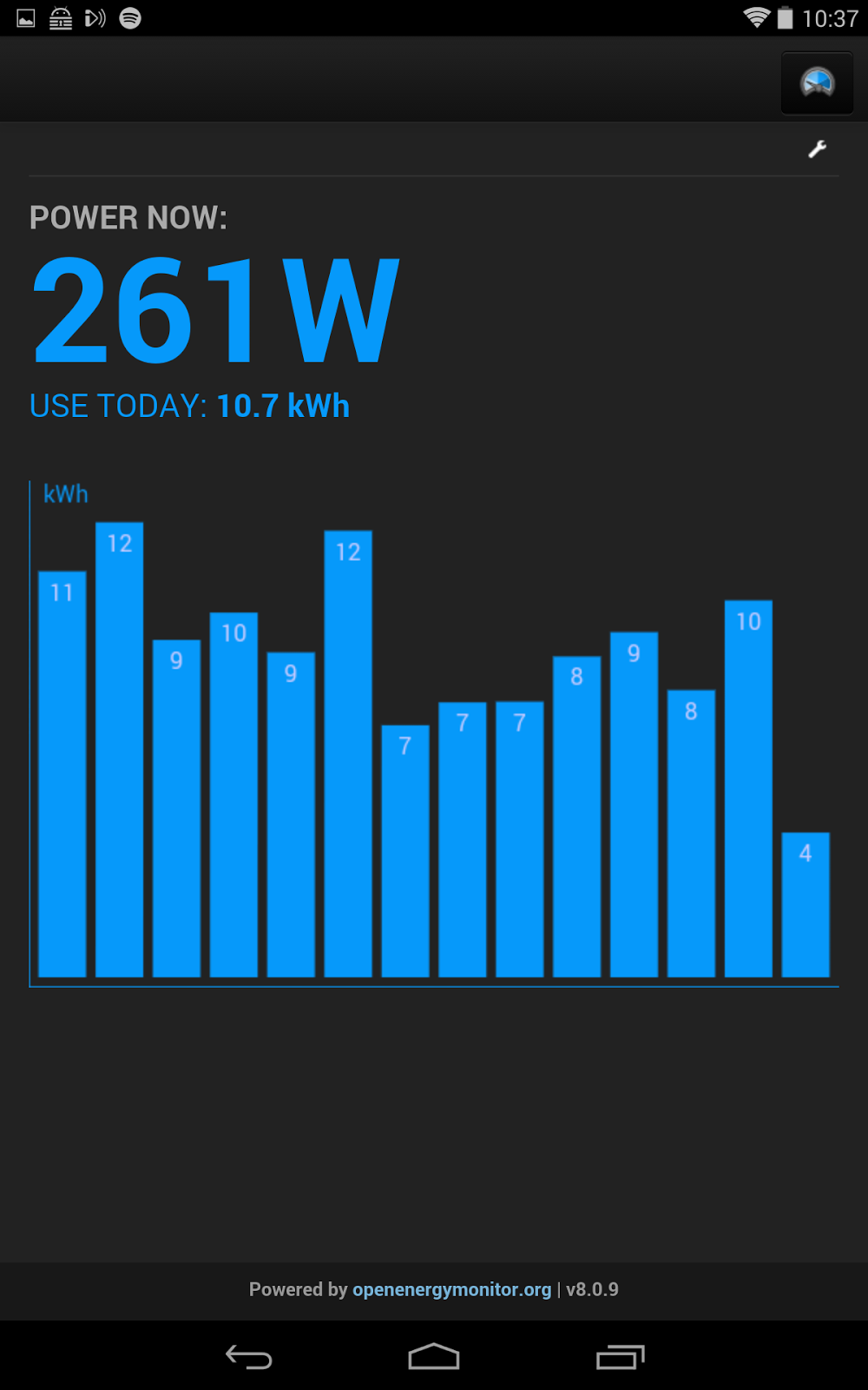

    How to draw a myelectric style bar chart
    Part of the android app tutorial series: How to build an Energy Monitoring android App P1
    Both the myelectric emoncms module and the soon to be myelectric android app have a bar chart that is written using the 2d graphics canvas. This short guide details how the bar chart is built and the first part is written to be applicable for different programming languages with examples in each particular language to come at the end, there's one for android java canvas at the moment.
    Writing custom graphs is not as complicated as I initially imagined it to be. Once you have a grasp of 2d graphics canvas sometimes its easier to write your own graph to get the style that you want. The myelectric graph was written from scratch in order to achieve a precise look: simple color scheme, bar height values overlayed on the bar, kWh label in the top-left corner.
    Tutorial: How to draw a myelectric style bar chart

    Emoncms Mobile View (My Electric)
    The latest version of Emoncms (V8) has got a feature called 'My Electric', this is a ready made mobile friendly dashboard.
    Just click the 'My Electric' button once logged into Emoncms and select your Power and KWh/d feeds. You will notice that that URL for this page automatically contains your API key, this is to enable this page to be bookmarked and easily accessed on a mobile device.
    If you use Chrome on both your desktop and mobile device your bookmarks will automatically sync. For even easier access Chrome on android allows web-pages to be pinned to the home screen for one button full screen access, this makes the Emoncms page load almost instantly, just like a native app giving a real-time dynamic view of how much power is currently being consumed or generated. Just follow the steps below:
    On first visit the My Electric page will ask you to select your Power and KWh/d feeds
    To create a shortcut on your android home screen hit the 'Add to home screen' button in Chrome
    A shortcut is now created on your homescreen to enable quickly firing up the dashboard
    When the homescreen short-cut is launched the My Electric dynamic mobile view page loads up almost instantly in Chrome in fullscreen mode (no URL bar etc.). This makes  it appear like a native app
