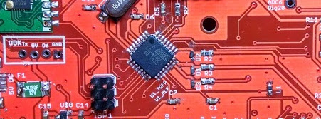

Semiconductor Grade Si 35000 MJ/kg, Taiariol et al. 2001EPROM Chip (M27C1001, 0.36 W IC) 12.5 MJ/chip, Taiariol et al. 2001Jean Claude Wippler of JeeLabs did an interesting post a couple of years ago on what is inside an ATmega8 chip. The Silicon part was extracted by dissolving the outer casing with sulphuric and nitric acid.
http://jeelabs.org/2013/06/09/whats-inside-that-chipThe size of the semiconductor part inside the ATmega8 is 2855 x 2795 um, less than 3x3mm:
Is it possible to estimate the embodied energy of a microcontroller by working out the embodied energy of the silicon part and the casing part separately? and how would the figure compare with the embodied energy values given for a small and large IC in the EU ecodesign dataset?

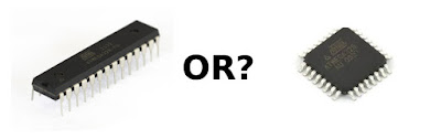

Package type?Calculating the embodied energy this way brings up an important question about the package type of the IC, I.e how much plastic and connector metal surrounds the semiconductor core. If the size of the semiconductor inside a through-hole and SMT version of a ATmega328 is the same then surely a total weight based measure is not a good guide for the embodied energy. Given that over 90% the embodied energy is associated with 3.5 - 12% of the weight.

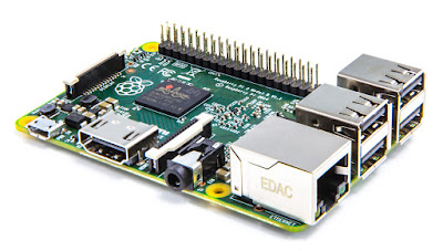

RaspberryPi chipsThe ATmega8 or ATmega328 is not a particularly powerful chip, the emonpi also uses a RaspberryPi which has three chips on board.
Its not clear what the volumes of the semiconductors inside these chips are. But given their small size and relatively large processing power lets assume for an initial calculation that the size of the package is very close to the size of the semiconductor. If the wafer thickness is 625um then the embodied energy of the chips can be estimated as:
Broadcom 14 x 14 mm x 625um = ~2.8 kWhElpida 12 x 12 mm x 625um = ~2.0 kWhSmst 8.7 x 8.7 mm x 625um = ~1.1 kWhThese estimates which cover a quad core 900Mhz + 1GB ram computer are much larger than the ATmega8 estimate as we would expect but are still significantly lower than the embodied energy figure given for the 32MB 2g memory chip referenced in the article on the
the monster footprint of digital technology of 20 kWh - while delivering much more functionality, almost a full computer!
