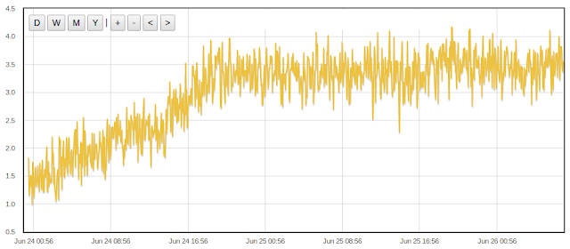

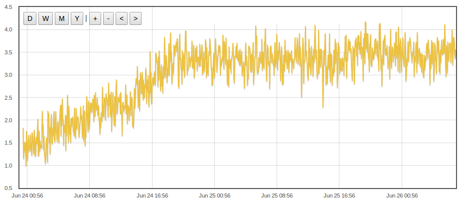

Load stat's for MYISAM vs INNODB for feed storage on the RaspberryPI
Here are some historic load stats for a raspberrypi running here, with 36 feeds being written to.
First using the INNODB storage engine:
A load of 3.5 causes an issue where the time that is recorded for data packets coming in gets messed up creating bunched up datapoints:
Switching the storage engine over the MYISAM, reduced the load to around 0.2 and the timing issue is no longer present:

Most of the time taken to handle posting data to emoncms, (input processing and feed updating) is taken up by requests to the mysql database. The php part of the code is usually pretty fast especially with Opcode cashing enabled such as APC.
Reducing the number of MYSQL queries required is usually a sure way to improve the performance of the application. Back in March of this year I re-factored the input processing implementation removing a lot of un-needed repeated queries as described at the bottom of this page: http://emoncms.org/site/docs/developinputproc
The results where really good, see the pic of time spent serving queries here

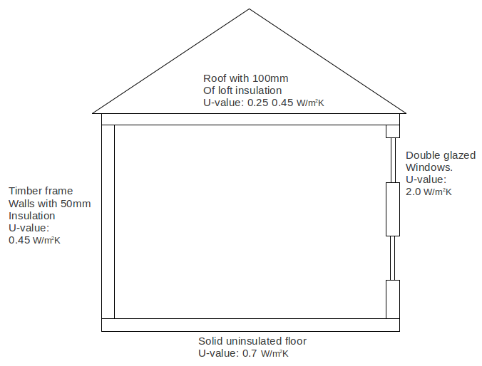

Building Energy Modelling: A simple javascript model
Putting what we covered in the last two posts together we can create a basic building energy model that covers building fabric heat loss and infiltration heat loss.
To start with the model extends the very basic example given in the first blog of the cube house by allowing for different building elements with different U-values: Walls, Roof, Floor, Windows. This is implemented in the same way as can be found in the full SAP model.
When calculating the heat loss from a building with multiple elements its useful to break the equation for building fabric element heat loss (Building fabric element heat loss = Area x U-Value x temperature difference)  down into three parts.
  1. Calculate the Area x U-Value for each element giving the heat loss in Watts per Kelvin (W/K) for that building element.
  2. Calculate the sum of the heat loss in W/K for all elements.
  3. Calculate the the total heat loss in Watts for a given temperature difference.
Here's an example house with a fairly simple range of elements, also added is an average infiltration rate for a modern house as covered in the last blog post.
Area
U-Value
W/K
Solid floor uninsulated
49 m2
x
0.7
34.3 W/K
Timber frame walls with 50mm of insulation
156 m2
x
0.45
70.2 W/K
Roof with 100mm of loft insulation
49 m2
x
0.25
12.3 W/K
Double glazed windows
12 m2
x
2.0
24.0 W/K
Infiltration: average modern house 1.5 air changes per hour.
1.5 x 0.33 x 294m3 =
145.5 W/K
TOTAL
286.3 W/K
Temperature difference
9.0 C
Heat loss (286W/K x 9C =)
2577 W
Annual total heating demand (including internal and solar gains)
22570 kWh
Note: We still need to take into account: solar and internal gains and seasonal temperature variation as a minimum before we get the actual demand on the heating system.
So that's all quite straightforward, the open source SAP implementation is written primarily in javascript with all the calculations happening on the 'client' (in the internet browser). The model combined with an interface updated in real-time makes for a dynamic experience with everything being calculated and visualised on the fly.
