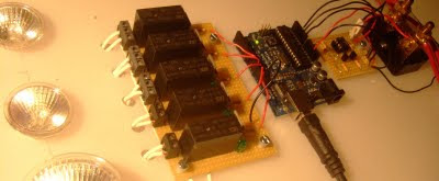

I have decided to go along the invasive current sensing route with a sense resistor (also known as a shunt). When dealing with such high currents the sense resistor needs to be quite beefy! Here's a picture of my test setup using a computer power supply to simulate the wind turbine and a 50W halogen as a load. The large block in the middle is the
sense resistor.

I will post up the results once its built, I also need to make a load that can vary between 0 and 500W so it can be tested properly, the current plan is to make that load from a mini 12V kettle and a mixture of 50W 20W and 10W halogen bulbs all of which can be turned on and off from the
Arduino. Should be fun!
