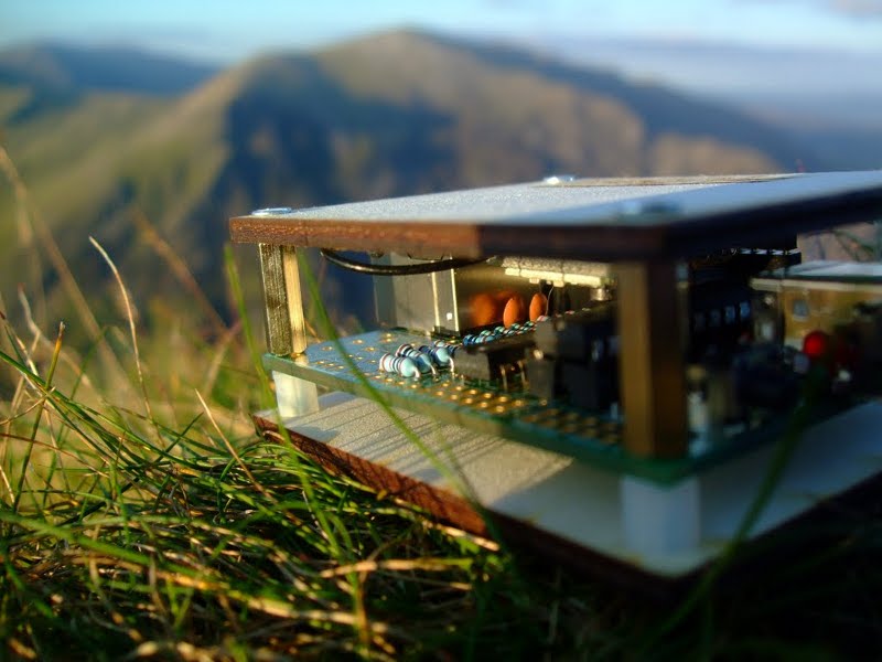

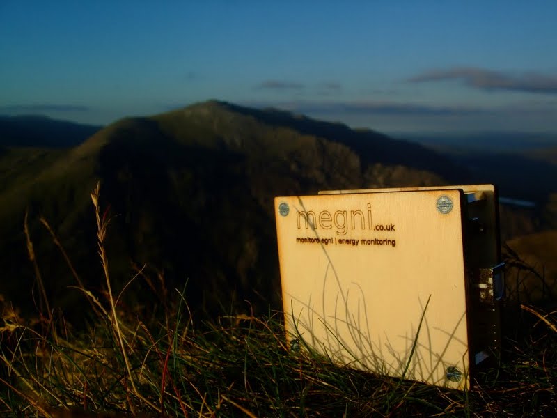

Nanode up in the mountains
Glyn took the emonBase - nanode up Snowdon last week and got some nice pics. Combining two great things: open source green technology and the great outdoors!
