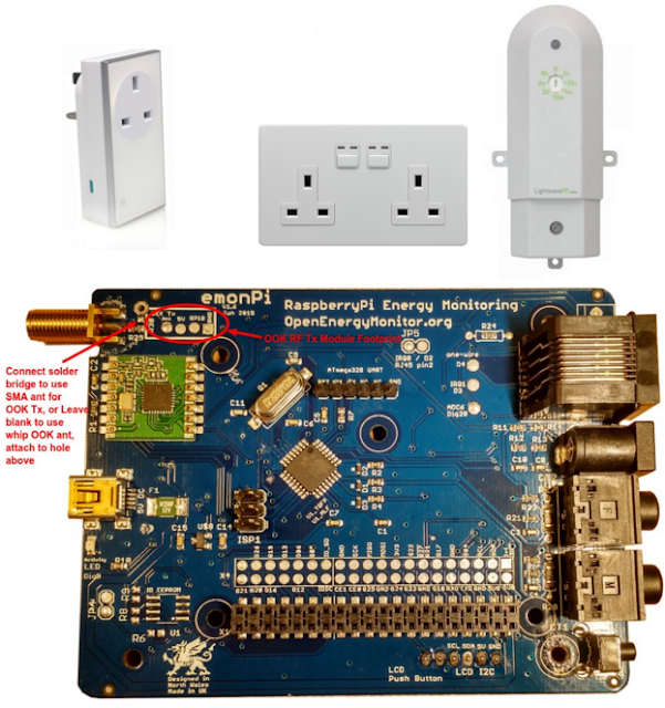

Many home automation products such as RF plugs, relays and heating remotes use a simple OOK (On-Off-Keying) wireless protocol. UK company LightWaveRF produce a variety of RF plugs and relays which can be controlled via OOK RF. The protocol is also compatible with some cheaper OOK learning receiver relays.  While maybe not strictly open-source the protocol and been reverse engineered allowing plugs to be easily controlled from Arduino / Raspberry Pi. There is an active LightWaveRF online community. Using off-the shelf hardware like this is a 'safe' way to control lights, heaters and appliances  around a home without getting our hands dirty dealing with with high voltages. These plugs and relays can be used to control anything from lights to immersion heaters, most LightWaveRF plugs/relays will switch up to 13A / 3kW.
Note: OOK protocol by it's simplistic nature is not particularly secure, I would not recommend controlling anything you don't mind getting accidently switched.
An OOK transmitter can easily be added to the emonPi.  We have started stocking OOK transmitter modules in the OpenEnergyMonitor store as well as adding an option to have OOK module factory installed on new emonPi's.
See emonPi Technical Hardware Wiki for details how to retrofit OOK TX module to existing emonPi's.

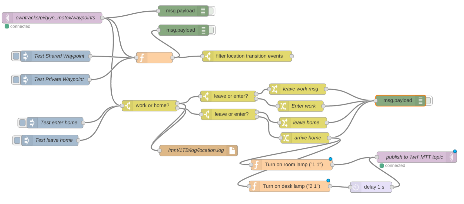

Now our plugs can be controlled via MQTT there are a many of options open as to how to control either via interface openHAB (blog post coming soon..), nodeRED, android Tasker etc.
I have been using nodeRED with input from android OwnTracks running on my phone to detect when I'm home and turn on a couple of lights:
Demo:
Using NodeRED and OwnTracks to turn on LightWave RF sockets when I arrive home:
