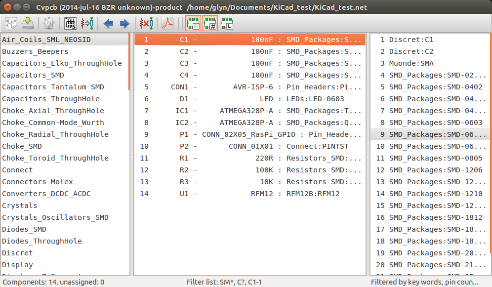

I found I needed to add the line "export KIGITHUB="https://github.com/KiCad";" to my ~/.profile file to get rid of cannot find github footprint errors when running CvPCB (the program in KiCad which links the schematic parts to PCB footprints)
I followed the fantastic video tutorials from Contextual Electronics to help me get started.
1. KiCad Schematic Editor, net list must be manually exported to move to the next setp
2. Linking schematic parts to PCB footprints
