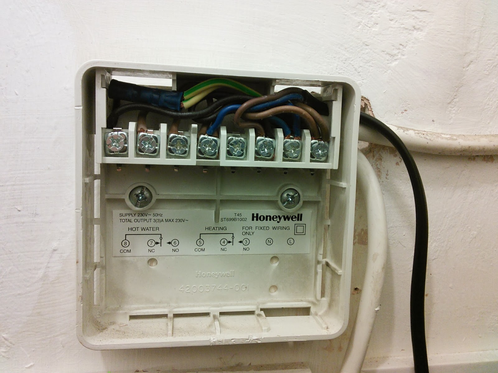

My old Worcester Bosch 240 with Honeywell controller requires connecting two terminals together to switch the heating on (see image below). I managed to wire in an additional control wire while keeping the original timer unit in place.
I used an emonTx V2 with JeeLabs relay module, this is just what I had to hand, any RFM12B node with an appropriate relay module could be used. We're looking into making a prototype PCB with an RFM12B, relay unit, on-board power supply and in-line energy monitoring (why not?!). The important consideration here is to make sure everything is properly enclosed and wired up to a high standard if you're controlling mains voltage. DON'T TAKE CHANCES WITH MAINS VOLTAGE.
It's important that the relay module used can handle the current being switched in my case this was only about 500mA @ 240V AC but if you're controlling an electric heating direct this is an important consideration.
Old Honeywell timer controller unit with front face removed - connect terminal 5 to 3 to turn heating on - black wire goes to relay (caution 240V AC)
