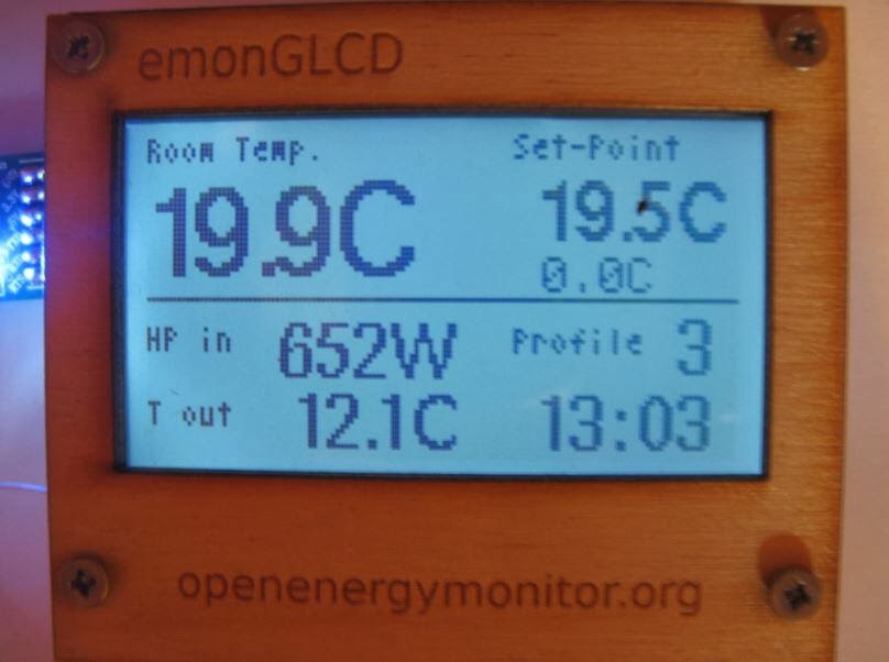

I visited John cantor of http://heatpumps.co.uk/ today who is implementing an impressive control and monitoring system for a heatpump central heating system which involves EmonGLCD's with relay's connected to radiator valve actuators in each room. The buttons on the EmonGLCD are used to set the target temperature for the room and information is displayed on the EmonGLCD about heatpump power input and outside temperature.

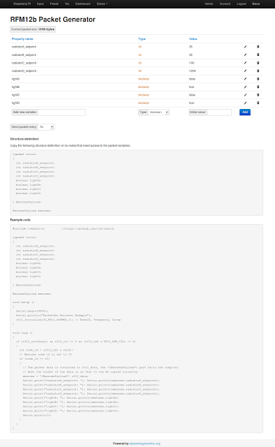

I like the simplicity of the way Jean Claude Wippler designed the jeelib library to use c structures as the method in which data is packaged and sent via the RFM12b radio's and so I thought that maybe a good basis for adding control functionality to emoncms would be to first make it possible for emoncms to easily generate RFM12b data packets in the format that can be easily decoded with a struct definition on the listening control nodes. Emoncms would then broadcast this control packet containing all the state information about the system at a regular interval in the same way as an emontx broadcasts it's readings. Listening nodes can then be programmed to selectively use variables in that control packet depending on what they need to do.
I've put together an initial working concept of a module that can be used to do this and its up on github here: https://github.com/emoncms/packetgen

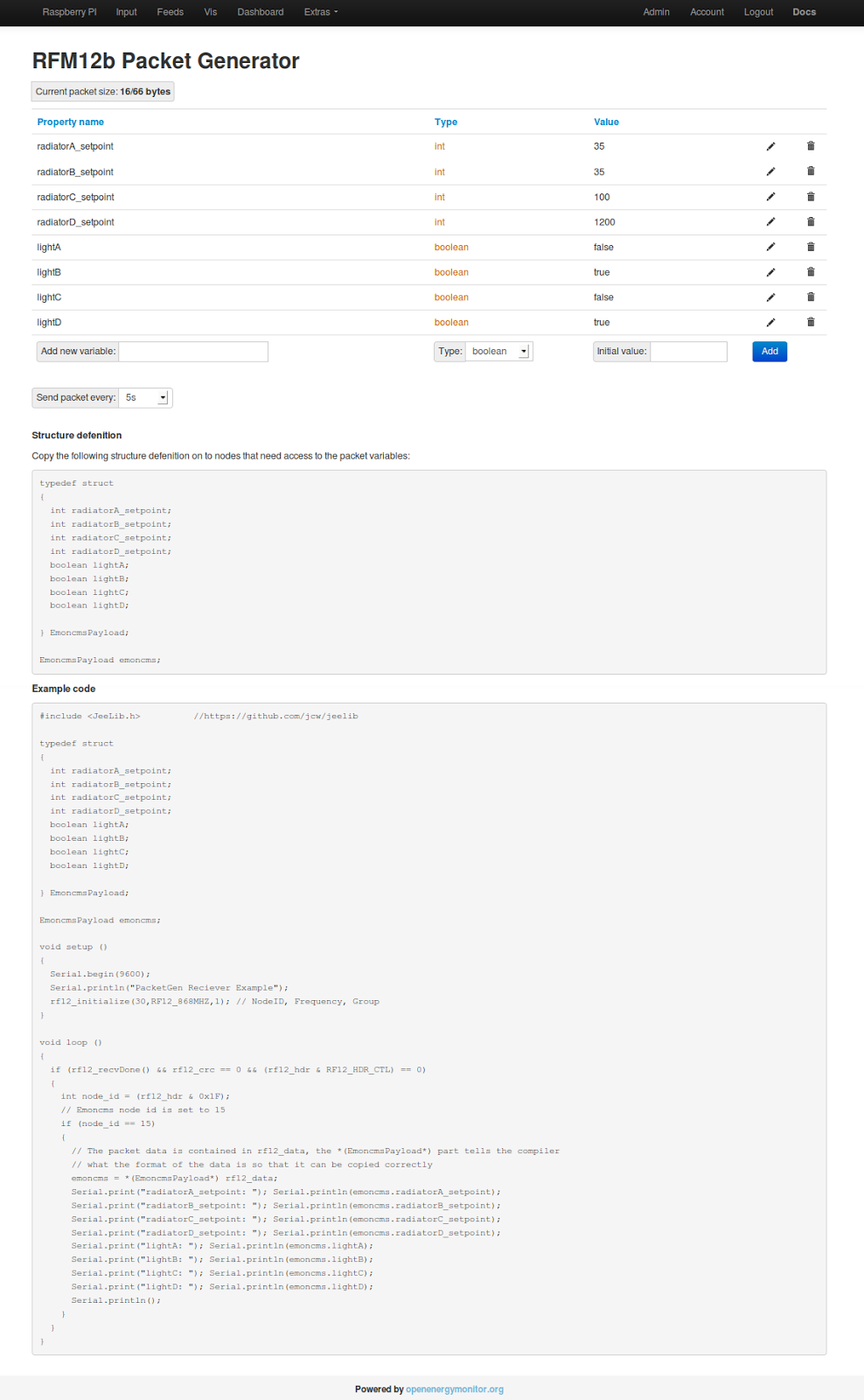

Here's a screenshot of the main interface:
One of the nice things about it is that as you generate your control packet the module generates example Arduino code to make it easier to start coding a control node, you can just copy the code any drop it into the Arduino IDE and upload to a atmega+rfm12b based node and it should start receiving the control packet right away.
