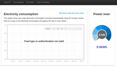

Private feeds and public dashboards
If you include a private feed in a public dashboard, the dashboard will not be able to retrieve the feed data and your dashboard is likely to look like this:
As all feeds with the implementation of this feature have been set to private all public dashboards will either have dials that are 0 and possibly visualisations that show the above message. If your visualisation is still working it may be because the javascript from the page is cached in your browser and you need to clear it.
