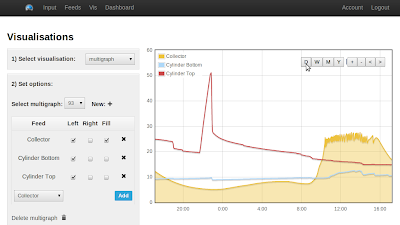

1) Start by going to the Vis tab and select the multigraph visualisation from the first drop down menu. In the second box you should now see a select multigraph drop down menu and a new + button. Click on the plus icon to create a new multigraph:
This will refresh the page, navigate again to multigraph in the first drop down menu, you should now see the new multigraph id in the drop down menu. Click/select the new dashboard id:

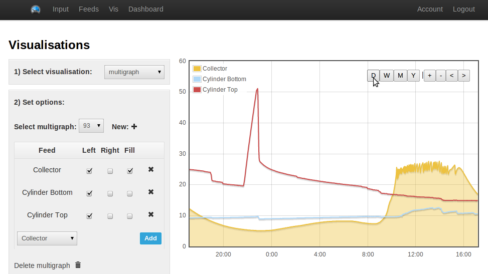

Select a feed from the add feed drop down menu and click on Add, this will add a feed to the multigraph feed list table. Put a tick in the left or right checkbox to specify the axis you wish the feed to appear on, you should now see the feed appear:

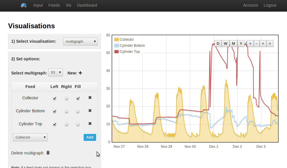

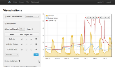

Add a few more, put a tick in the fill box to fill in the area below the curve:
Select a default time range by clicking on the day/week/month/year buttons. When you reload the multigraph it should now appear at the time range given. If you'd like the multigraph to load a specific fixed time range just zoom in on the area you want it to show, the next time you load the multigraph it should load your last view.

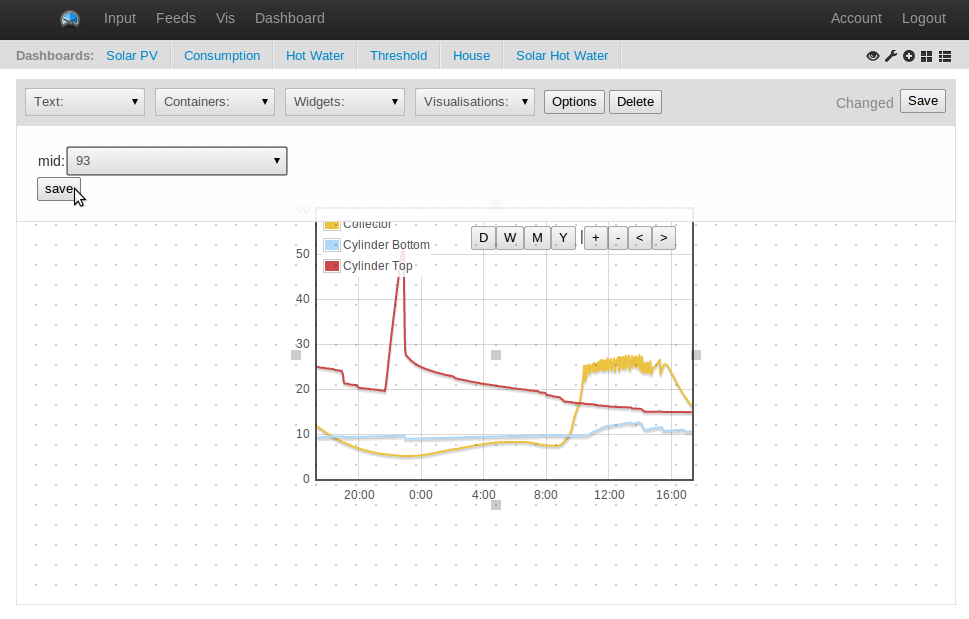

Add a multigraph to your dashboard by selecting multigraph from the dropdown visualisation menu.
Click on the blank dashboard and click on the Options button. Select the multigraph you wish to show from the drop down menu and click save.
