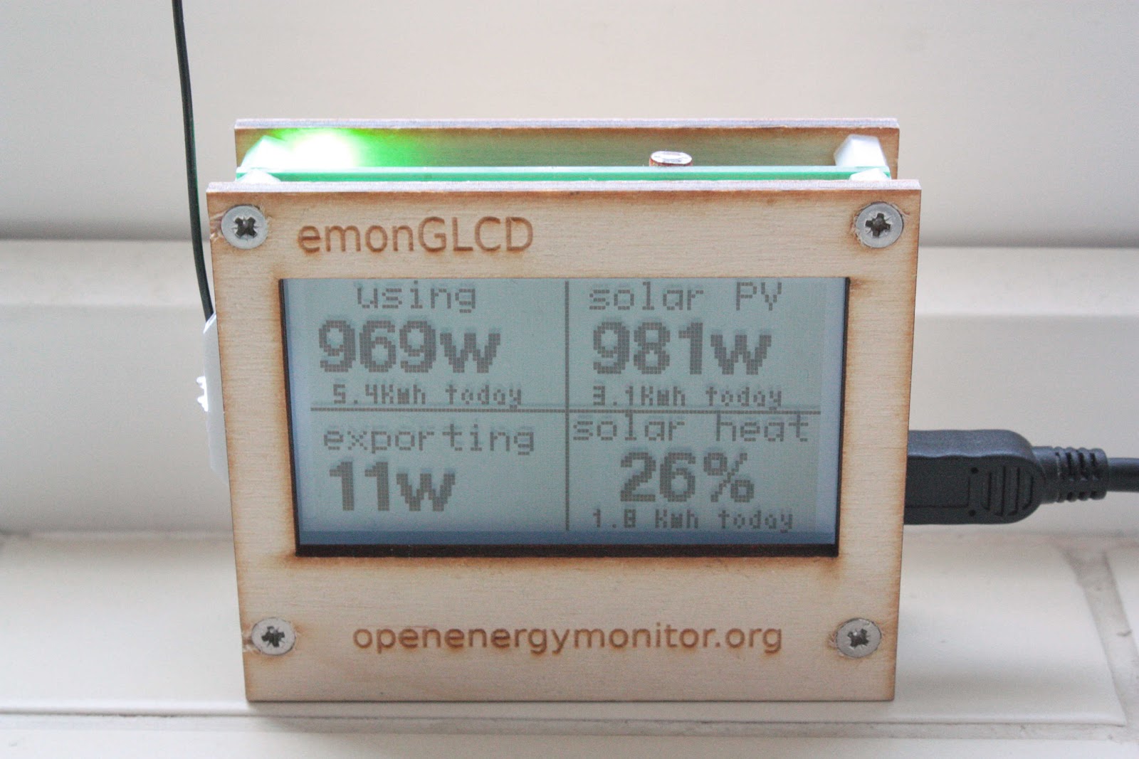

As there appears to be a considerable amount of interest in getting an emonTx unit running Robin’s MK2 code (calypso_rae on this forum) and communicating with emonGLCD / emon Base … I thought it was about time I publish where I am at with my project.

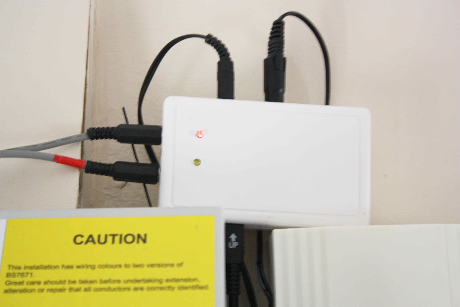

The emonTx with CT1 connected to the Grid, and CT3 connected to the Solar PV generation meter, AC psu and 5v USB supply are also connected.
![](http://3.bp.blogspot.com/-ePo_WfKqfoI/ULEiH9DxikI/AAAAAAAAc1Y/_9GkfZ0RQGA/s400/emonGLCD+Diverting.JPG) |
emonGLCD with modified code |
![](http://1.bp.blogspot.com/-PoJvZwH7HzU/ULEiT-Sp7fI/AAAAAAAAc1o/Xpa1rBxfAwA/s320/emonTx+boxed.JPG) |
emonTx with additional tri-color LED to indicate immersion heater status |

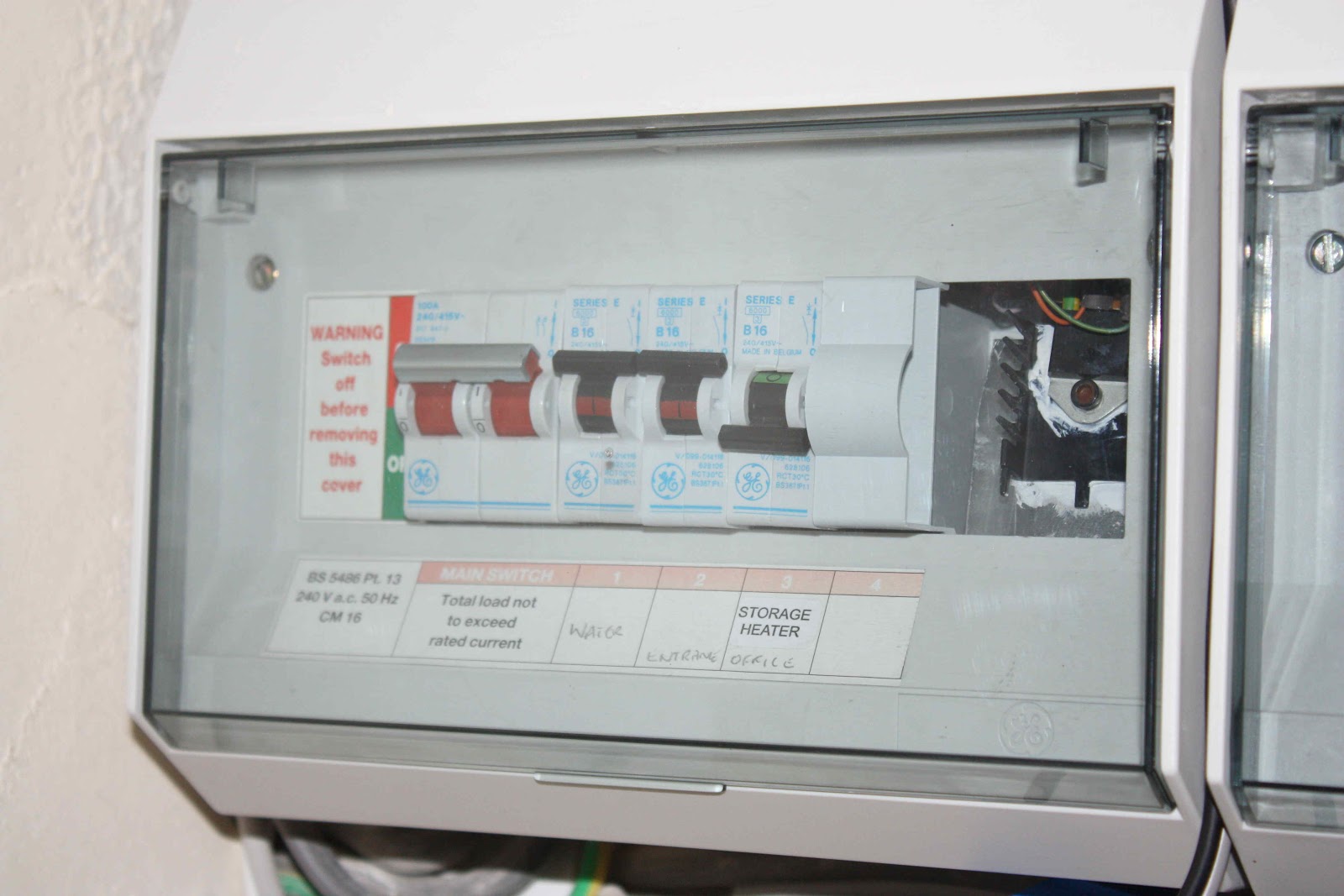

![](http://3.bp.blogspot.com/-gl4dP3fIijE/ULEiBPOsqZI/AAAAAAAAc1Q/lWiOlpdaok8/s320/DPCU.JPG) |
Consumer unit containing MOC3041 triac |
