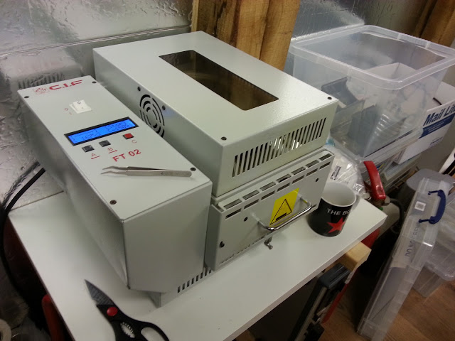

3. After a quick visual check the board with the placed components is put in the reflow oven for a precise amount of time at a carefully monitored temperature profile. This melts the solderpaste and solders the components into place.
![](http://2.bp.blogspot.com/-4c_g_-BKx9g/UJIfsZwVYmI/AAAAAAAAcv8/-zcKpxjinxg/s320/20121030_144900.jpg) |
Reflow Oven |
