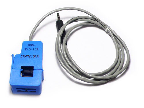

The emonTx Shield has got four CT current sensor inputs, an AC voltage sample input, on-board temperature sensor and RFM12B wireless transceiver. With just a CT sensor the shield can monitor current and apparent power. With the addition of an AC-AC adapter to provide an AC voltage sample the shield can monitor real power, AC RMS voltage and power factor.
