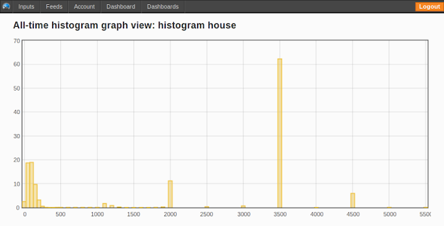

The histogram shows the energy (KWh) used at a particular power (watts) which allows analysis of what types of devices (low / medium / high) are using the most energy.

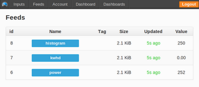

3) Click on Feeds to bring up the feed/list page, click on the histogram feed:
4) In the histograms feed/view page click on the graph type histogram:
5) Once you have been logging histogram data for a few hours you will start to see histogram bars form at the different levels of power that you use. This histogram graph shows energy used at a particular power for all time. So is a really useful tool for measuring what is the total energy used by the electric immersion water heater for example, we've used 62 kWh @ 3500W since April 13th.
