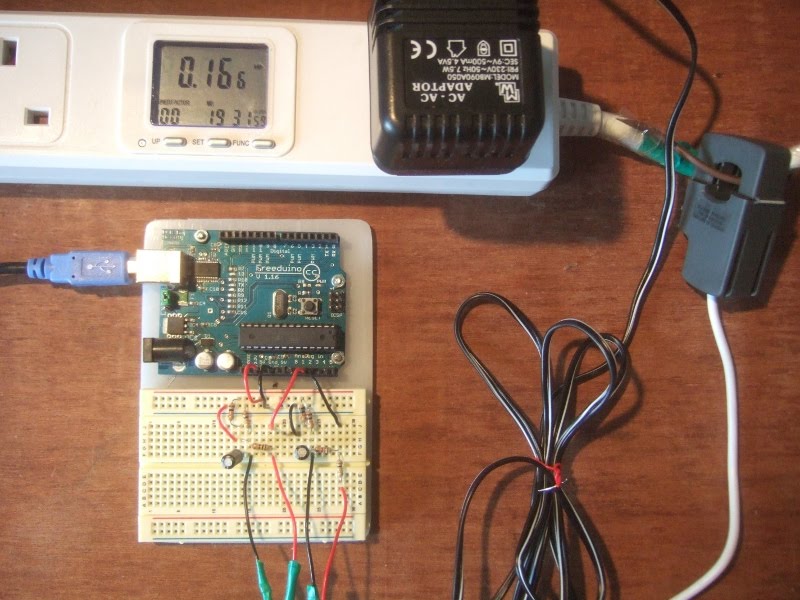

Mains AC: non-invasive version 3.0 up
The documentation for version 3 of the Mains AC: non-invasive energy monitor is up. It can be found here:
The main changes are:
Electronics
  • 2x 10uF bias stabilizing capacitors added significantly improving accuracy: more info
  • Changed Voltage measurement circuit
  • Power for arduino comes from a seperate transformer to AC voltage measurement transformer.
Software
  • Arduino sketch rewrite, sketch now follows Atmel's AVR 465 app note method, adding:
    • Phase calibration
    • Digital high pass filter to remove offset.
Other
  • Much simplified calibration
