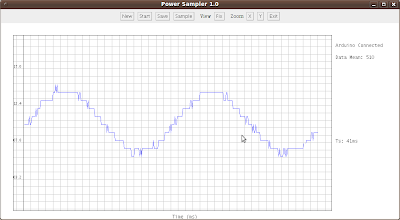

Here's a screenshot measuring the same lamp as I was measuring above with the energy monitor powered from the laptop connected to the mains but now with the 10uF capacitor across the 2.5V bias:
Very steppy but this is due to the small magnitude of the signal versus the ADC resolution which is expected, the large noise fluctuations have disappeared.
