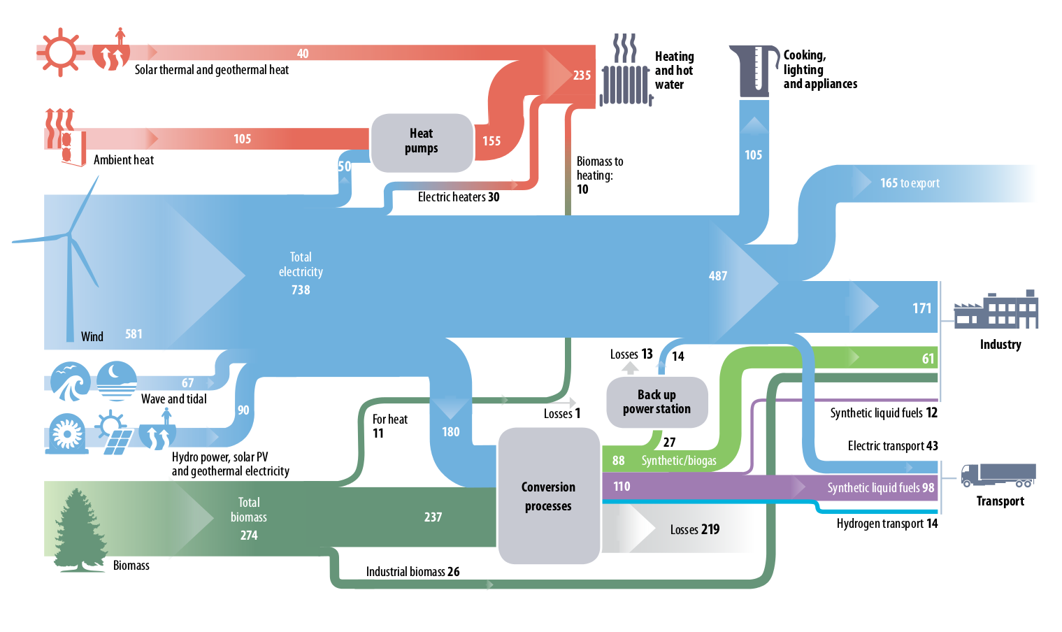

Heatpumps in the ZeroCarbonBritain model by the Centre for Alternative Technology.
This sankey diagram from the ZeroCarbonBritain report gives an overview of the energy flows in their scenario, with heat pumps providing the bulk of the heating and hot water demand:
Heat pumps provide 66% of final space and water heating demand, providing 155 TWh of heat from 50 TWh of electricity – an average coefficient of performance of 3.1.
ZeroCarbonBritain also include 30 TWh of direct electric heating. The total input electricity for heating is 80 TWh and total heat delivered 185 TWh which together is an average COP of 2.3.
This 80 TWh of electricity demand is around 20% of the final direct electricity demand or 11% of the total renewable electricity generated as 47% of the electricity generated is used during times of excess production for export and synthetic fuel production, plus backup power to gas.
By using heat pumps for heating ZCB reduces the amount of renewable energy that would otherwise be needed to provide our energy needs.
