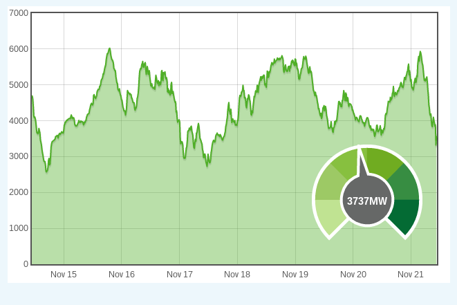

Following on from my blog post creating an ambient indicator to indicate wind turbine renewable electricity generation we have extended the Emoncms UK electric grid statistic aggregation to calculate and record the UK electric grid carbon intensity i.e. the amount of carbon emitted per kWh (CO2/kWh). As before we have created a dashboard open API for easy access to this data.
| http://emoncms.org/ukelectricitygrid/ukgrid |
| http://emoncms.org/ukelectricitygrid/ukwind |

The data is captured from the UK Balancing BM Reports XML. Our figure for grid intensity matched the figure generated by http://www.gridcarbon.uk/.
