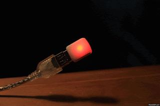

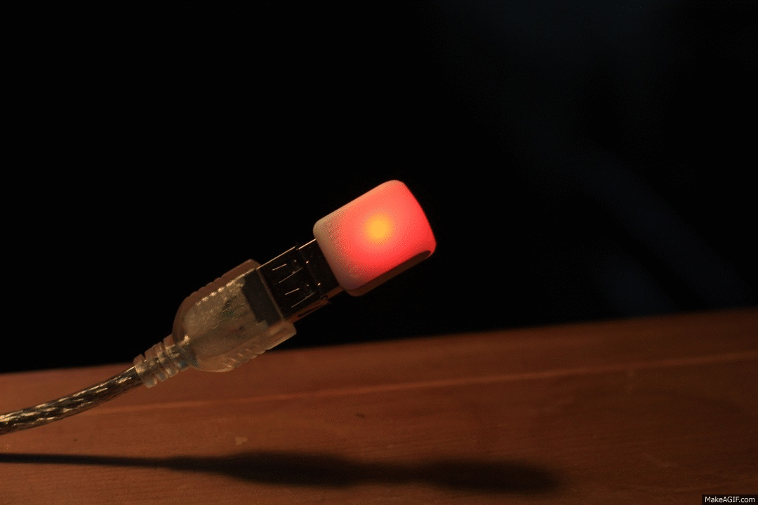

I've used emoncms.org, Node-RED and a ThingM blink(1) USB RGB LED plugged into an emonPi energy monitor to create the indicator.

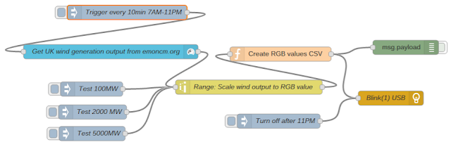

Node-RED makes it super easy to link the required software components together, with pre built nodes available for emoncms and Blink USB it's just a case of linking the nodes together and adding some logic. Here is now node-RED flow, see node-RED export at bottom of this post:
| Real-time wind energy indicator |
| Blink USB Indicator |
We have a script running on emoncms.org to pull in real-time UK wind energy generation. We have been logging this data for almost a year now. Checkout the dashboard here: http://emoncms.org/mywindpower/ukwind.
The read API key for this account is 8f5c2d146c0c338845d2201b8fe1b0e1 and the feed ID is 67088. To pull the real time data into node red just plug in the api key and feed ID into the node-RED emoncms in node. Node-RED will then execute the following GET request:
| http://emoncms.org/mywindpower/ukwind |
The blink usb node requires RGB csv to represent a colour output. A node is used to map the generation 0 - 7000 MW (currently!) to 0 - 255 RGB representation.
