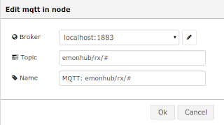

There are two options to get our energy data into Node-RED:1. Real-time data from emonHub using MQTT (see example below):
MQTT is a lightweight communication protocol for small web-connected devices. The latest version of emonHub as setup on the emonPi (and emonHub from July 15) uses MQTT as a link to Emoncms and also to provide data to the emonPi LCD script. Since MQTT is already running all we need to do is to point Node-RED MQTT input block to subscribe to the 'emonhub/rx/#' MQTT topic on port 1883. The '#' topic includes data received from all nodes. To subscribe to just one node use e.g. emonPi use: 'emonhub/5/values' or 'emonhub/10/values' for emonTx.

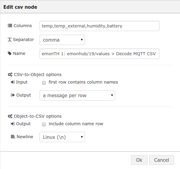

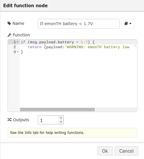

Simple but useful example, use Node-RED connecting to emonPi in real-time data via MQTT (localhost) and sending email (via Gmail SMTP) if emonTH battery drops below 1.7V. Also in this flow as an example is a node to decode emonPi power data.
Here is the contents of each node:
| MQTT Node subscribing to emonhub mqtt topic on localhost (running node-RED on emonPi) |

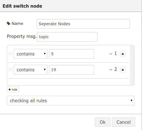

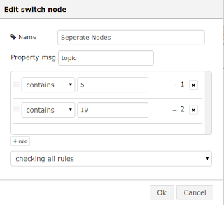

| Separate node to split the MQTT data up into nodes based on ID: e.g emonTx = 10, emonPi = 5, emonTH = 19 |
| CSV node to split up MQTT CSV string |
| If function node |
