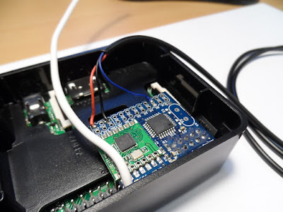

By connecting a optical pulse sensor directly to the rfm69pi adapter board this can make a relatively low cost solution for internet connected pulse counting (or local logging to emoncms running on the raspberrypi).
Setup
1) The RJ45 connector on the optical pulse counter needs to be removed and individual wires exposed. Connect the red wire to 3.3V, the black wire to GND and the blue wire to D3:
