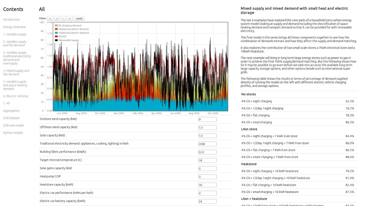

I started by writing a series of python models that modelled many of the key components in turn using the full 10 year hourly dataset used in the ZeroCarbonBritain spreadsheet model, exploring the level of supply/demand matching for each generation technology. As I started to model some of the more complex demands such as space heating from heatpumps, including the effect of solar and internal gains, I needed to be able to see what was going on in more detail so I converted the models to javascript and wrote a data viewer using flot.
Online visual tool
I've put all these model examples together into an online tool and added alongside each model a brief analysis and extended results of the many model run's I ran with different parameters. The tool also includes an introduction and overview of the uk energy context which is intended to help put the model examples which focus on domestic traditional electricity demand, space heating and electric transport in context. This tool is now available online here:
