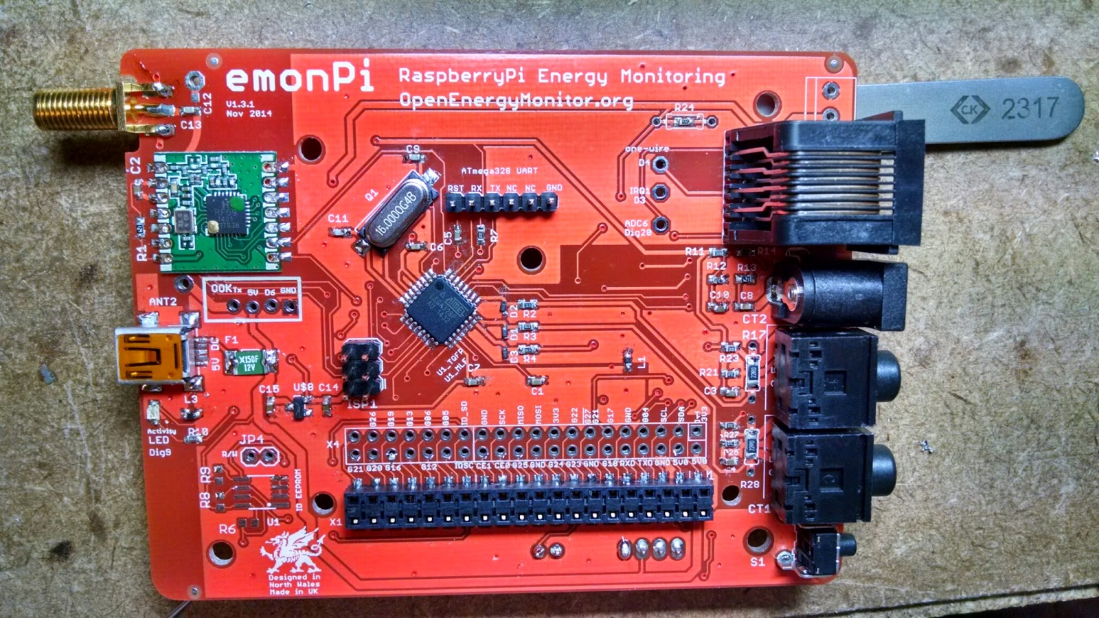

| RFM69CW on the upcoming emonPi Raspberry Pi Energy Monitoring Shield (due for launch in the new year) |
