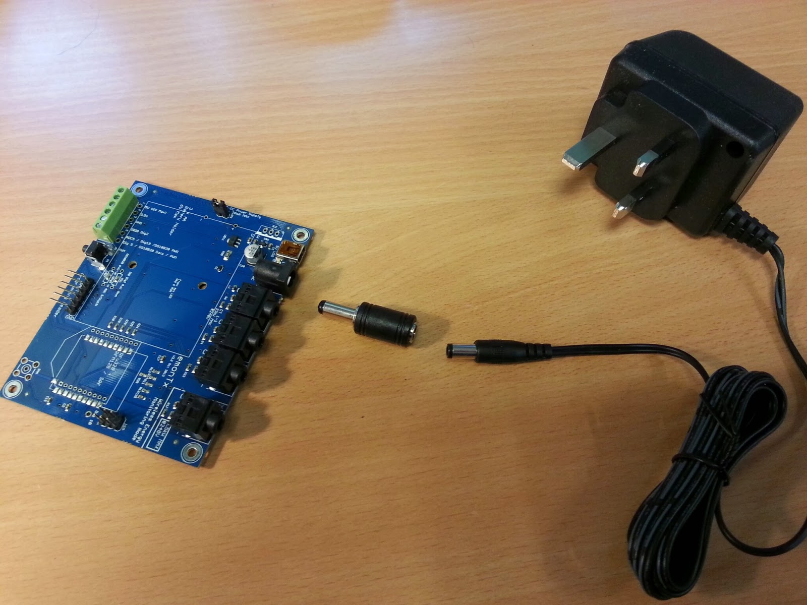

Just quick post to highlight a small bug in the first batch of emonTx V3...there had to be something!
The barrel-jack socket on the first batch of emonTx V3's has got a middle pin with a diameter of 2.5mm. Our adapters don't fit since they are 2.1mm..Doh!
To solve this we're shipping a little adapter unit with each emonTx V3:
The AC-AC adapter is important and very useful on the emonTx V3 since it can power the unit as well as simultaneously providing an AC voltage sample for IRMS and Real Power readings.
