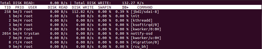

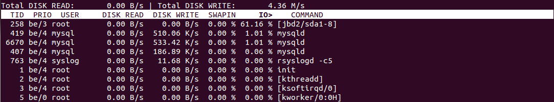

Using a larger number of vm readings than the 5 listed above the average redis input was 215kb/s and mysql 4430kb/s, idle being 4kb/s. First its surprising how high the mysql write rate is and then second its surprising how large the reduction in the amount of disk writing done is, about 21x less and that's with 4.7 times the post rate. The reduction in the amount of writing could therefore be as much as 100x. The quanitiy of writes cannot only be explained by the kind of writes that are being done in emoncms, most of it appears to be due to ext4 filesystem journaling (61.16% of write capacity) while mysql is only responsible for a couple of percent.
MySQL iotop
Redis iotop Journaling
