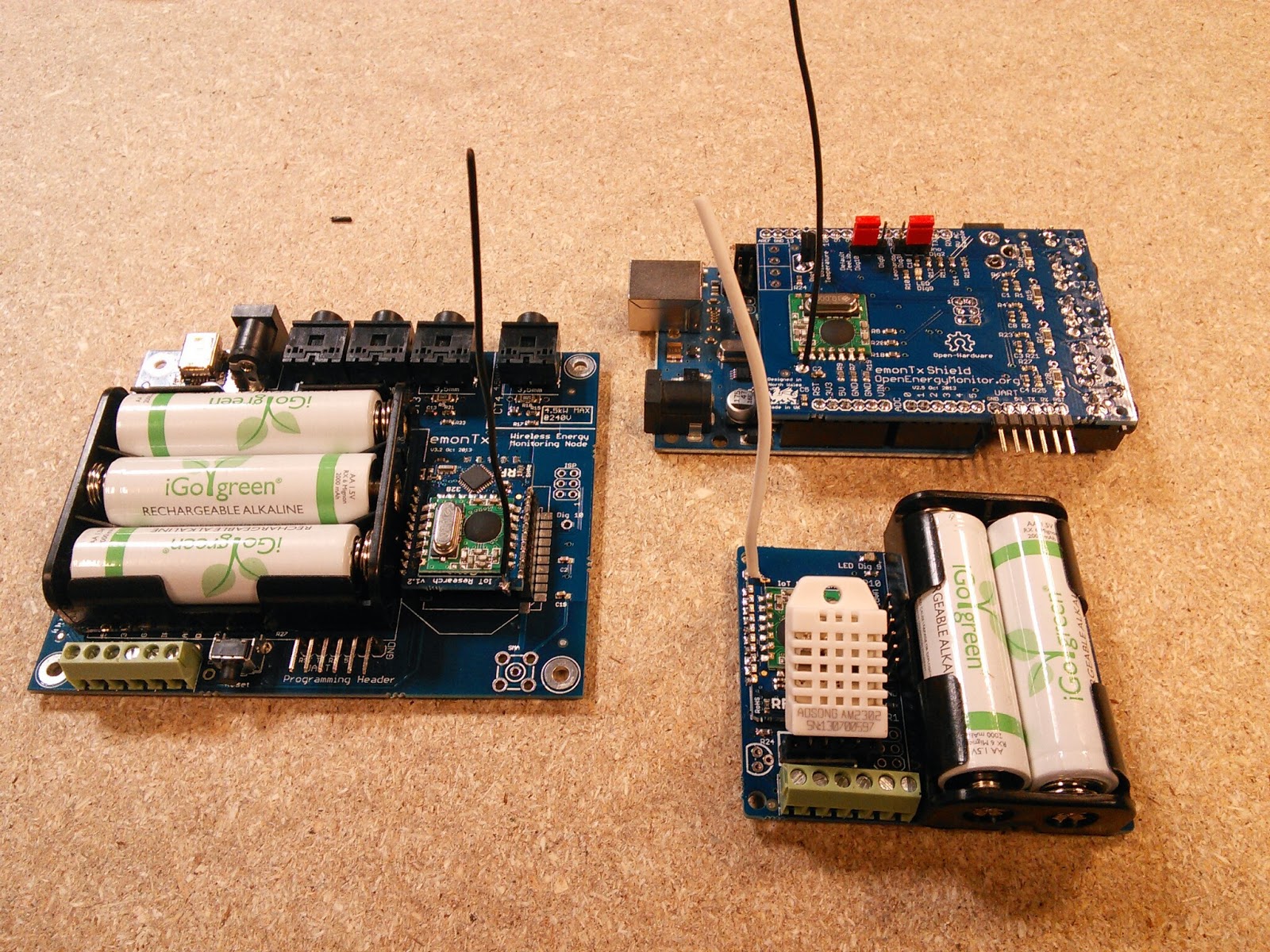

Even though the designs have undergone several iterations and have been extensively tested over the past 12 months or so it was still a nail biting moment assembling, powering up and testing the final designs. Luckily it all went smoothly and all functions on all three designs seem to be working exactly as planned..just as well since we have 500 PCS of each!
| Building up the final productions designs..scary! Thankfully it all went smoothly |
| Final designs for emonTx V3, emonTx Arduino Shield SMT and emonTH all working! |

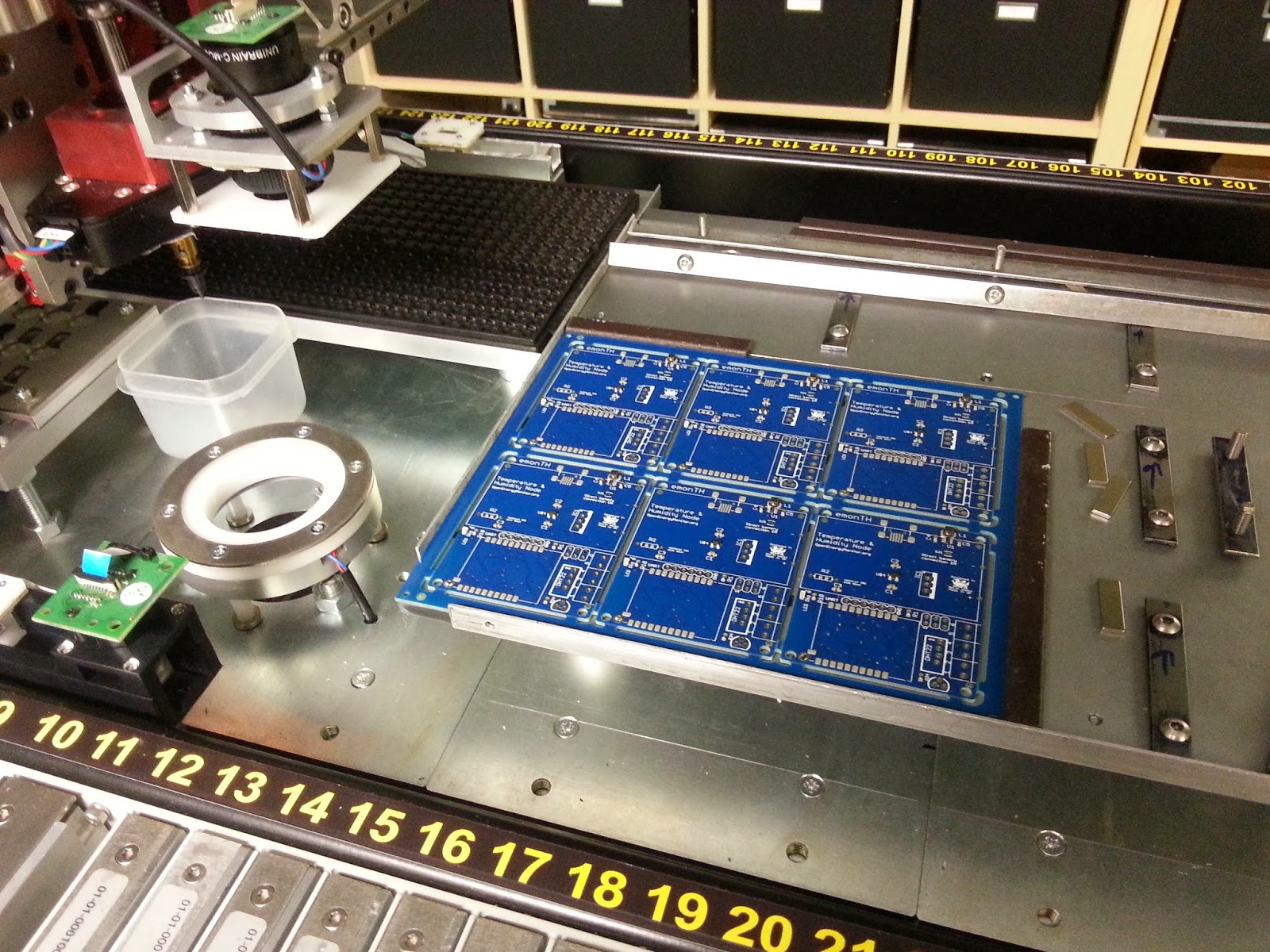

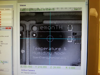

| Step 2: Setup the pick-and-place to identify the 'fiducials' on the emonTH...Google it! If you look hard you will see these little shiny round marks on all SMT boards. |

Step 4: let the pick-and-place do it's stuff! I love watching machines at work
| Step 5 & 6: Reflow the board in the oven then add the thru-hole bits |

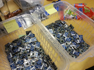

| Step 7: Test, test and test! Here's show's testing of the RFu328 (ATmega328 MCU + Radio) modules |
| Step 8: Done! |
Unfortunately we had a few issues during step 7; a some of the RF12B's which were reflowed onto the RFu328's were not working as they should. We think this was down to the large MCU package on the RFM12B absorbing more heat during the reflow process than expected. For the next batch we will look at tweaking the reflow oven's temperature profile. For now we will be hand soldering the RF modules. These sorts of niggles are not uncommon in manufacture, this is why testing is so important. We will be testing the units at several stages before they're shipped to ensure all functions are working.
