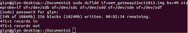

Finally run dcfld selecting each SD card as the output file:
$ sudo dcfldd if=SD_CARD_IMAGE.img bs=4M sizeprobe=if of=/dev/sdb of=/dev/sdc of=/dev/sdd of=/dev/sde of=/dev/sdf
Flashing five SD cards with a 2GB image takes about 4 min for me:
