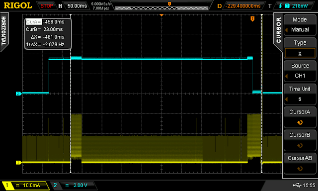

The power consumption results are as follows, assuming one reading is taken per min and using this battery estimation tool assuming AA capacity of 2200mAh and not taking into account AA self-discharge*
emonTH with DS18b20 temperature only (Vin = 2.6V)
On current: 9.7mA for 70ms then peaking to 26mA for 2.8ms for RFM12B transmission, giving average of 10.2mA for 9.8ms
Approximate battery life of 3.5 years*
emonTH with DHT22 (temperature & humidity) only (Vin = 2.6V)
Sleep Current: 0.12mA
On current: 9.5mA for 1700ms then peaking to 26mA for 2.8 ms for RFM12B transmission giving average of 9.525mA for 1703ms
Approximate battery life of 1.1 years*
