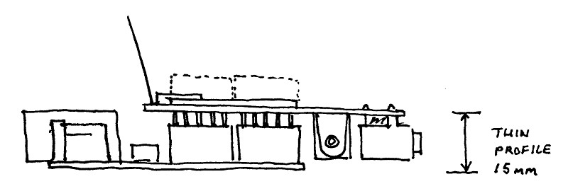

Several weeks ago we got an email with a series of pictures showing the problem that the emontx shield does not stack well with many of the base boards and other shields it may be used in conjunction with.
It got me thinking about different ways the shield could be arranged that would make it stack better with a variety of different boards. The main idea I had was to move the AC-AC Adapter and CT inputs over to the other side of the PCB away from the side the Ethernet and USB sockets are usually located on most of the Arduino boards and the NanodeRF. The second idea was to mount these sockets on the underside of the PCB which allows for a really thin profile NanodeRF + EmonTx shield stack which I think is pretty neat if a little unconventional. Here's the concept drawing:

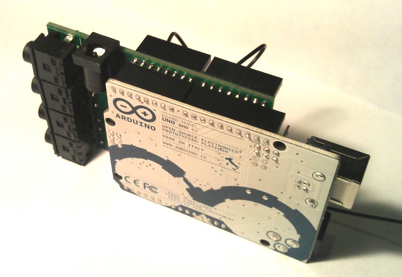

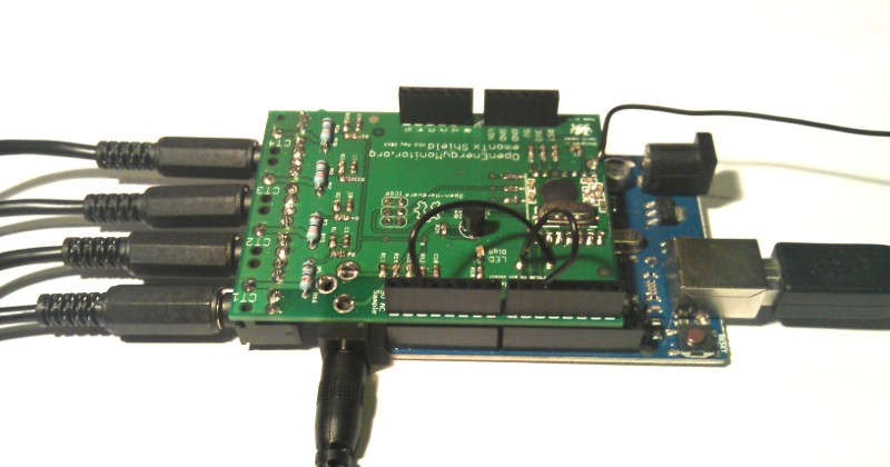

The PCB's arrived on Tuesday, I built it up and have started to test it, so far everything seems to be working, energy monitoring part, RFM12, Led, DS18B20 temperature sensor, Arduino Uno, Arduino Duemilanove. Next I will test the NanodeRF and Id also like to test an Arduino official Ethernet shield.
Things to improve
There is a very slight misalignment on the ISP header that needs fixing although it still stacks together fine and Glyn pointed out that the option to choose different SS (SEL) and IRQ pins for the RFM12 could be achieved using a manual jumper rather than solderable pads. Id also like to add a terminal for the DS18B20 on the edge of the board for neater connection of temperature sensor strings.
