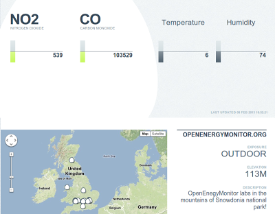

IoT Cloud - Cosm is used as the data store for the AQE. A neat open-source Ruby web-application has been written to display a crowd sourced web-dashboard with a nice Google map showing egg monitoring locations.
| http://airqualityegg.com/ - let's get some more European eggs activated! |
| Example Air Quality Egg Readings from the OpenEnergyMonitor labs, readings may be in-correct. Sensors take a few days to 'burn-in'. See here for the live version: http://airqualityegg.com/egg/103153 |
