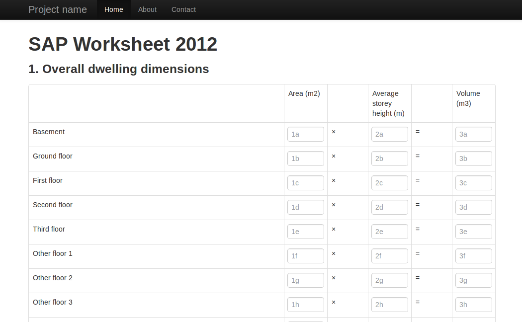

An open source SAP calculator - Matt and I made a start on an open source web based SAP worksheet - SAP is the UK Government’s Standard Assessment Procedure for Energy Rating of Dwellings produced by BRE the Building Research Establishment. We've put the progress we have made so far up on github here: https://github.com/emoncms/sap
Please get in touch if your interested in helping to develop this, we could do with more help with completing the form and checking and implementing the remaining calculations.
