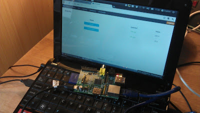

Just got emoncms installed and running on the raspberry pi here, here are my installation notes:
1) Initial setup
Download the debian squeeze image from: http://www.raspberrypi.org/downloads and write to an SD card, following the guide here: http://elinux.org/RPi_Easy_SD_Card_Setup.
Insert the sd card into the pi, power it up connect up a screen, a keyboard and ethernet.

10) In an internet browser, load emoncms:
http://YOURIP/emoncms3
That's should be it!
