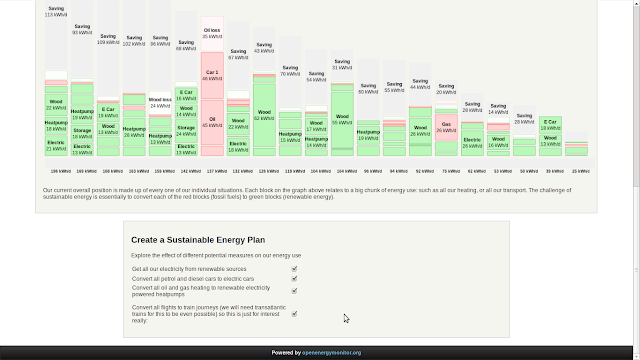

1) Fill out a single household energy audit, compare how your energy picture compares to the average UK household energy use and how it relates to the Centre for Alternative Technology Zero Carbon Britain 2030 energy scenario:
2) Aggregate data from each household to create a group view:
3) Explore how group scenario is built up of individual households contribution:
4) Explore future energy scenarios, see the effect of switching to electric cars, heatpumps etc on real household data from your group:
5) In the next version, see effect of energy efficiency measures, insulation, draft-proofing and see the cost and payback details of scenarios including a comparison of different measures by sustainable energy % increase impact per £.
The idea is that through this process we can help bring focus to areas and solutions that can have most impact and also give a tangible reference of progress so that milestones can be celebrated when achieved.
The application is largely inspired by David Mackay's book Sustainable Energy Without the Hot Air (free to read online) as you can see from the use of the energy stacks. The aim is also very much about creating a tool that helps to create sustainable energy plans that add up and in the spirit of openenergymonitor and David Mackay's book the application is open source.
