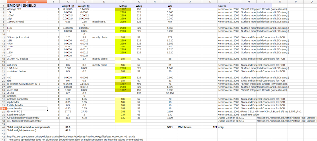

I then calculated an estimate for embodied energy by using the embodied energy dataset from these two sources and a detailed list of components for the emonpi including the weight of each component. The spreadsheet with the calculation can be downloaded here on the EmonPI open hardware github repository:
https://github.com/openenergymonitor/Hardware/raw/master/emonPi/emonPi_V1_5/emonpi_embodiedenergy.ods
here's a screenshot of what it looks like:
I have summarised the main results in these two graphics:
Interestingly the application of the embodied energy values in the dataset suggest that at least for the parts that we are most involved in the custom design of (The EmonPi Shield and the aluminium enclosure) the embodied energy is dominated first by the enclosure at 10.1 kWh and then by the manufacturing of the printed circuit board (2.2 kWh) and the assembly of the unit (1.6 kWh). The integrated circuits only account for a relatively small percentage at 0.2 kWh.
